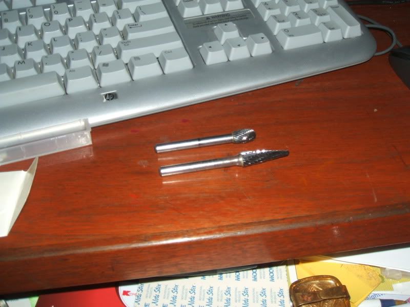

Did some reading and a bunch of research and then picked theses up
Most of the sites I cam accrossed say that these are the two types of burr tools you want to use.  I would have gotten a Ball and a Straightener Barrel but they cost more than 40 buck for the ones they had in store at Production Tool in Novi.

thatll work now do you have a die grinder, disasemble the heads and only go around to the gasket where you drew on 1'' inside dont go and consentrate on the walls or get carried away. if you listen you realy cant screw up. i was 16 when i did my first full port job. ( and yes i have screwed up) once! take your time, just 1'' in will do it.
