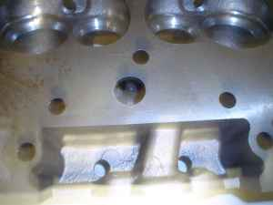

i found a set of bare casting world sportsman heads on craigslist. i just cant figure out what the chamber volume is.... i asked for the casting numbers and part numbers and heres what i got: h26, 95 NW I-037
anybody got any ideas?

heres a pic... a bad one but is there any way to guess if its 64cc or 72cc? ==idunno
did a little more research. these are sportsman II's   200cc runner, 64 or 72 cc chamber

i was looking at that. but it dont describe how to tell what the combution chamber size is tho... at least not that i saw...

do you have any valves for it? if so put the valves in one cylinder and a spark plug in it get a syringe or something you can measure cc's with and fill the chamber up, the pic kinda looks more like a 72 than a 64, but that's gonna be as accurate as you can get man
got a close machine shop that can cc those?
