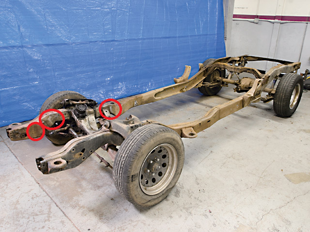

Spots to take a look at. Mostly between the perches of the front leaf springs. Prolly best way to re-enforce would be just put a couple 2x6'' 1/4'' flat pieces across where the crumple points are and weld all the way around them. ==dunno
I'd box the rest of the frame personally but I dont really care about weight like most ==roll

Sweet I will check them spots out
My 98 frame is boxed all the way to rear axle, I'm going to box the rest
