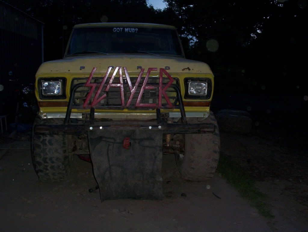

I got the front insert made and painted today.
Here is what it looks like
The Bronco has a new look.......  Let me know what you think

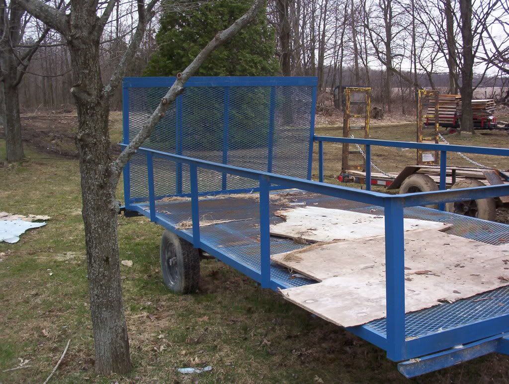

the bronco will get painted when the weather warms up a bit here is a pic of a trailer I built 2 years ago the bronco will be the same color as this.
~SwampRAT~
......not a fan of it but hey, not my truck anymore!
mudslayer2008

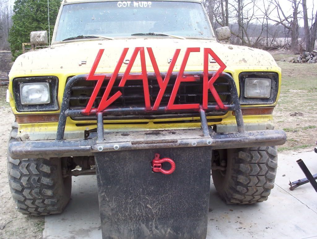

well i decided the "SLAYER" on the front doesn't look as good as I thought it was going to so it may get relocated on the back or I might just airbrush it on after I paint the bronco.
~SwampRAT~
dont wanna sound like an a$$ hole but it really takes away from the ford front clip with it there. i think it would look bad ass if it was air brushed on after you paint it though. good choice man, love what you have done with it so far. cant wait to see it actually get some good mud time.

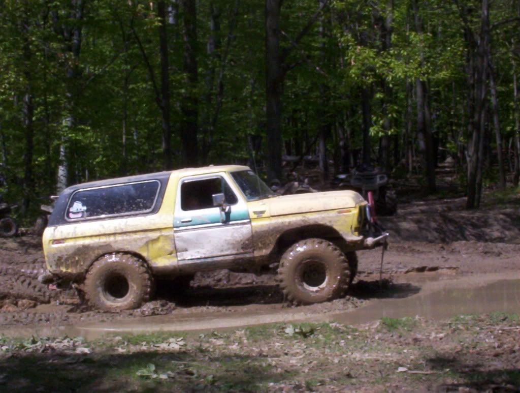

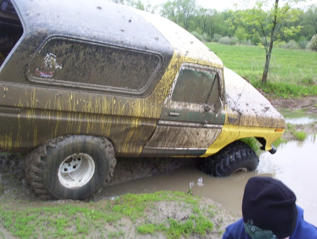

well I am building a 2" or 3" body lift for it this week and possibly getting a minispool for the rear.
here is the reason I am putting the lift on it
~SwampRAT~
ya, it needs it pretty bad. that was another project i never got to on it. looks like she kicked some ass out there this weekend though. glad its running good for ya!

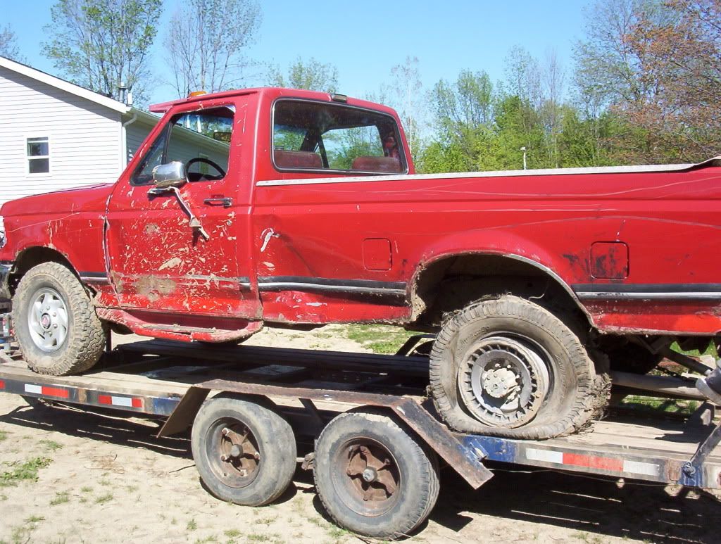

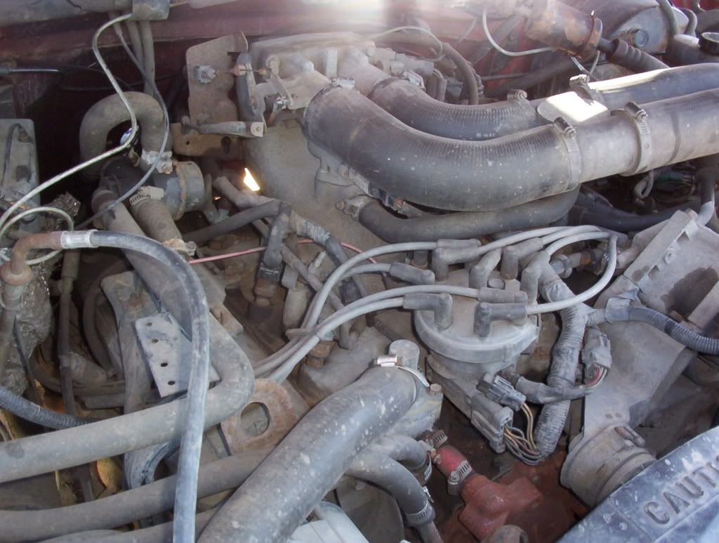

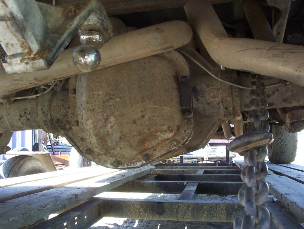

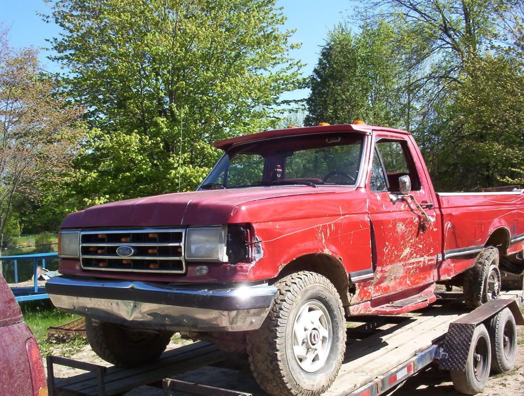

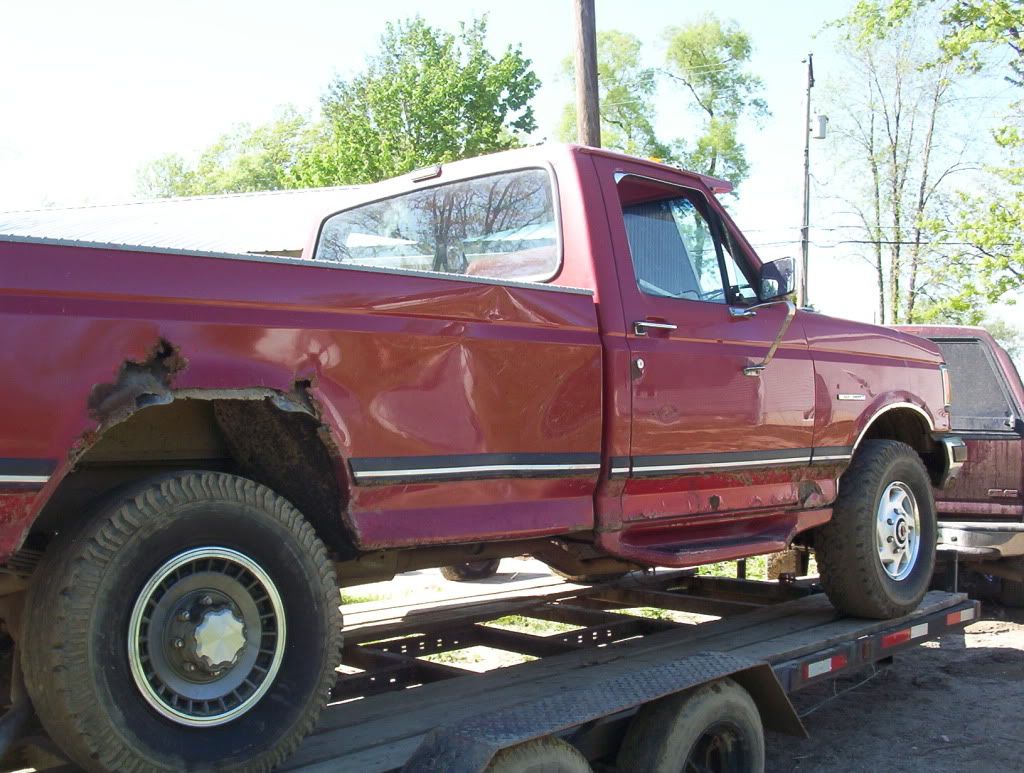

I bought this truck today for parts.

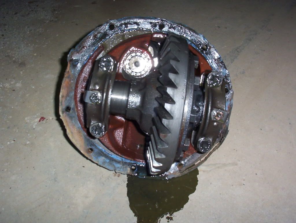

the main reason I got it is this,   fuel injected 460 bbf
and this,  dana 60 rear

I ordered the mini-spool today. Can't wait to get it and get this thing done. swaping out the t-case this weekend and hopfuly getting the body lift done as well so when my spool gets here I can put it in and go play.
mudslayer2008

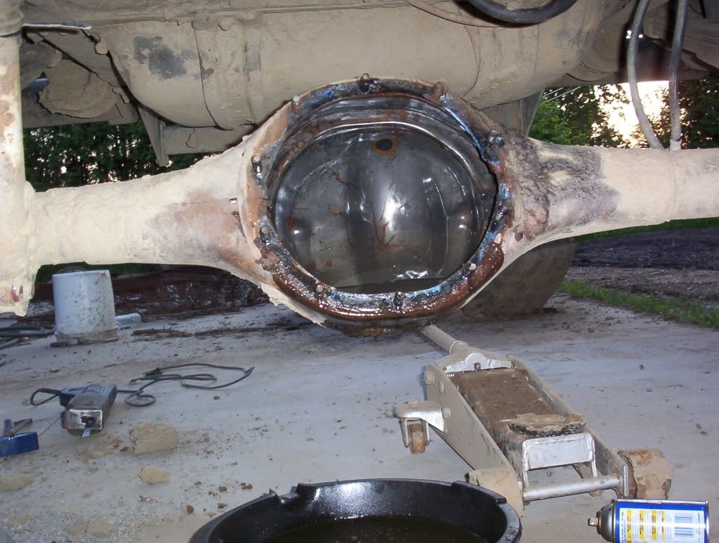

rear end is torn apart waiting for the mini-spool to get here.  can't change out the t-case because this np 205 is attached to c4 trans and the input shaft is differant so I'm stuck with the 203. I'm starting the body lift tomarrow after examination of the body mounts there are only 4 that are good the rest is either broke or pulled thru the frame. I'll get pix as I go.

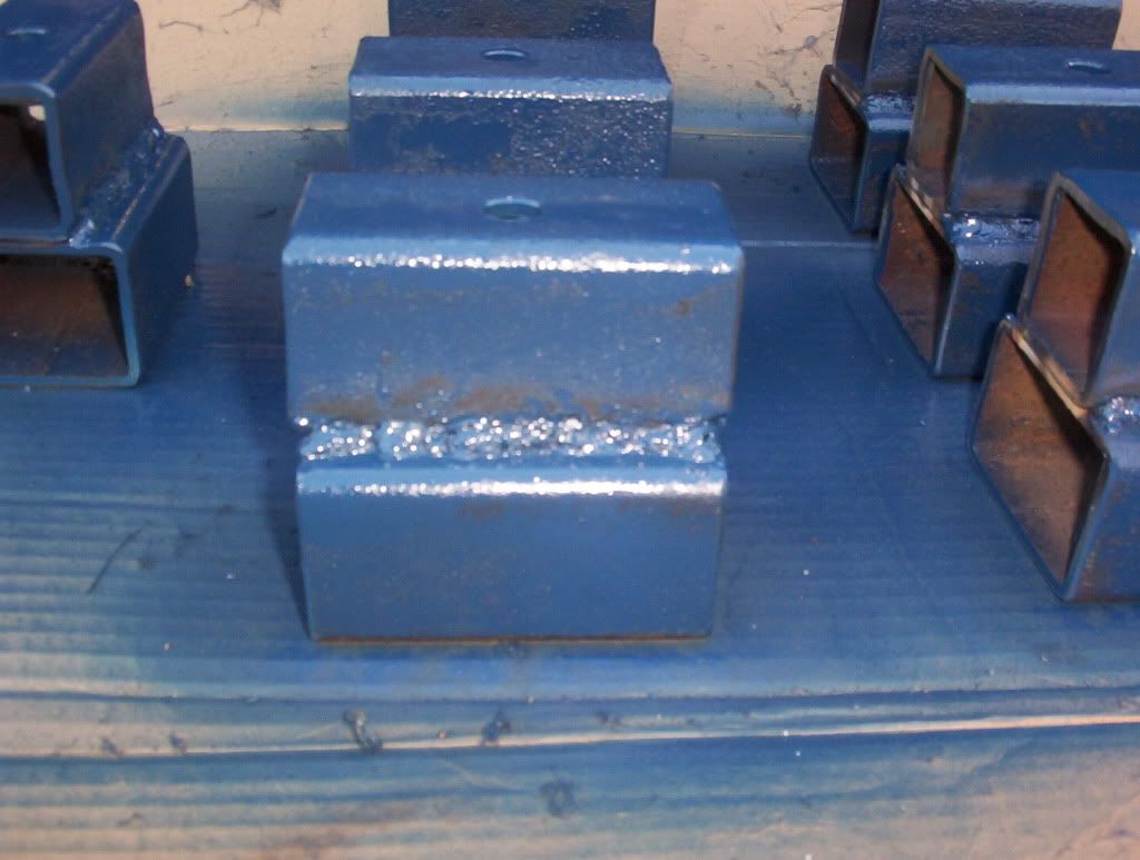

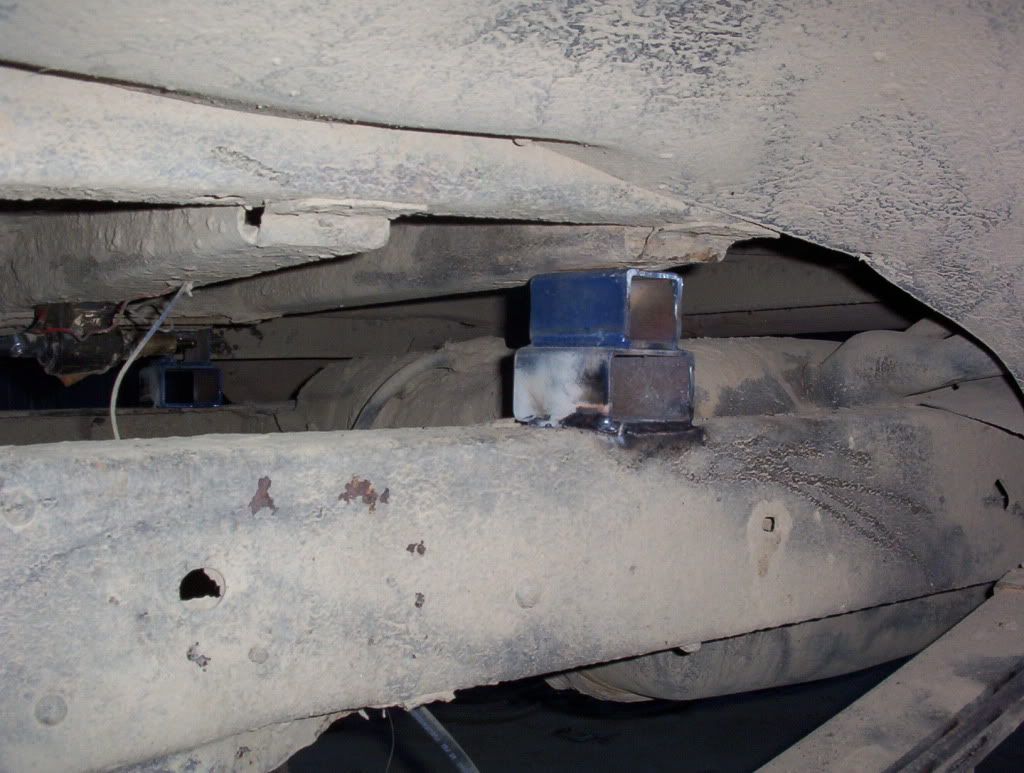

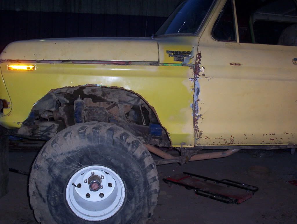

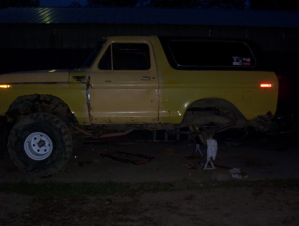

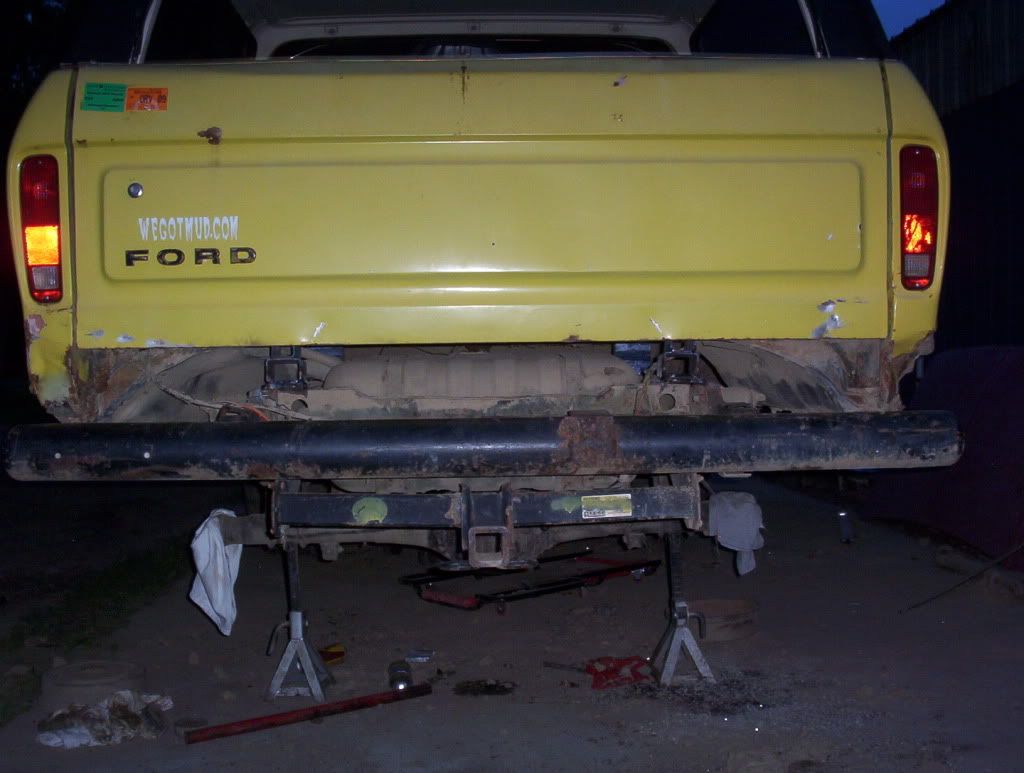

I got the body lift blocks made today they measure 4" high but they will only give me 3" of lift.(the rubber body mounts measure 1" thick and I'm not reusing them)
here is how the bronco sits right now.
here is the third member awaiting the mini-spool
mudslayer2008
#98
The body lift is done sorry the pics are kindda dark I was losing light outside fast.
before
after
