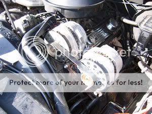

dont meen to hijack the thred, but has any one ever ran two alts? that might help. i have herd about it but havent been able to find a hole lot of info about it

guess i need to know the logic behind this
catfish
well the logic i got out of it is that two is beter thatn one and its cheper to by two of the self alts than one high end one. also the two factory alts give you more power at idal than one high end alt

i see makes sense, i just use a 100 amp 1 wire works well for me. but everyone has their own opinion. thanks for the info on the double alt. learn somethin new everyday
catfish
no problum, thoaught it was a good idal just ant two sure how it would afect HP usaly the more you put on the serpentine belt the les ther is at the weels

Quote from: catfish on February 21, 2009, 04:29:18 AM
http://www.off-road.com/trucks4x4/Project+1993+Chevy+K1500/Serious-12-Volt-Power-for-Your-Chevy-CK-Series-Tru/ArticleStandard/Article/detail/308036?contextCategoryId=45795
I dont know but I do know that is a kick ass idea. You would never be stranded because of a bad alternator either because if one goes bad you still would have a working alt to get you home. I wish I could find out how he wired them?
