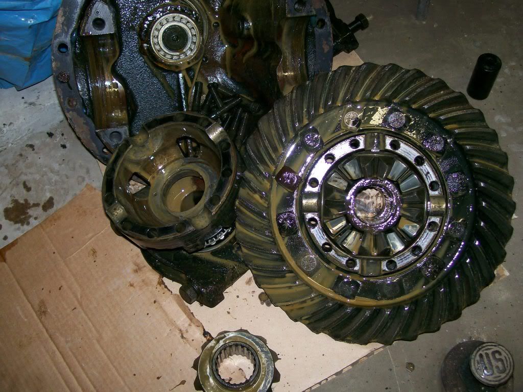

Oh p00   CRAZY TIME?????  I think i like that!!!LOL  Axles are Rockwells, and yea gonna live in the shop. Hope to have it done in 90,000 days.LOL
No secrets on the motor it won't be a FaFa Faord LOL
Here's a couple pics from today;

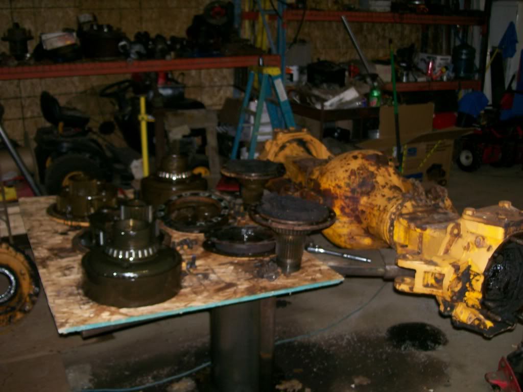

Axle tear down to weld spiders found some bad bearings, the other axle has a locker but will be tearing down to check bearings
"WTF"

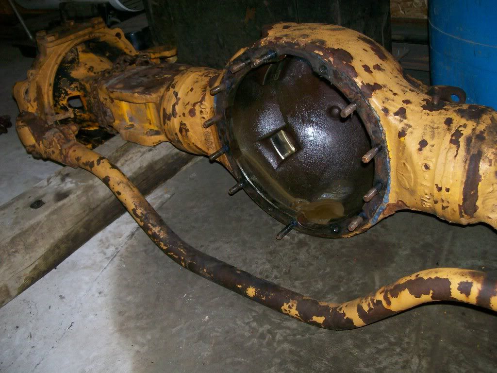

Dave, what are those axles out of?  Sky-track type thing?
wildtime
No not sky track  Not sure but I think some sort of EndLoader

those look like the same axles i can get my hands on

Yea those axles are wicked! saw em when i picked up a tire, there pretty damn big

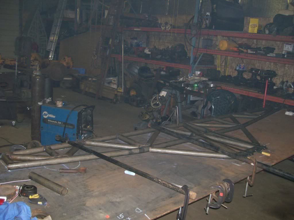

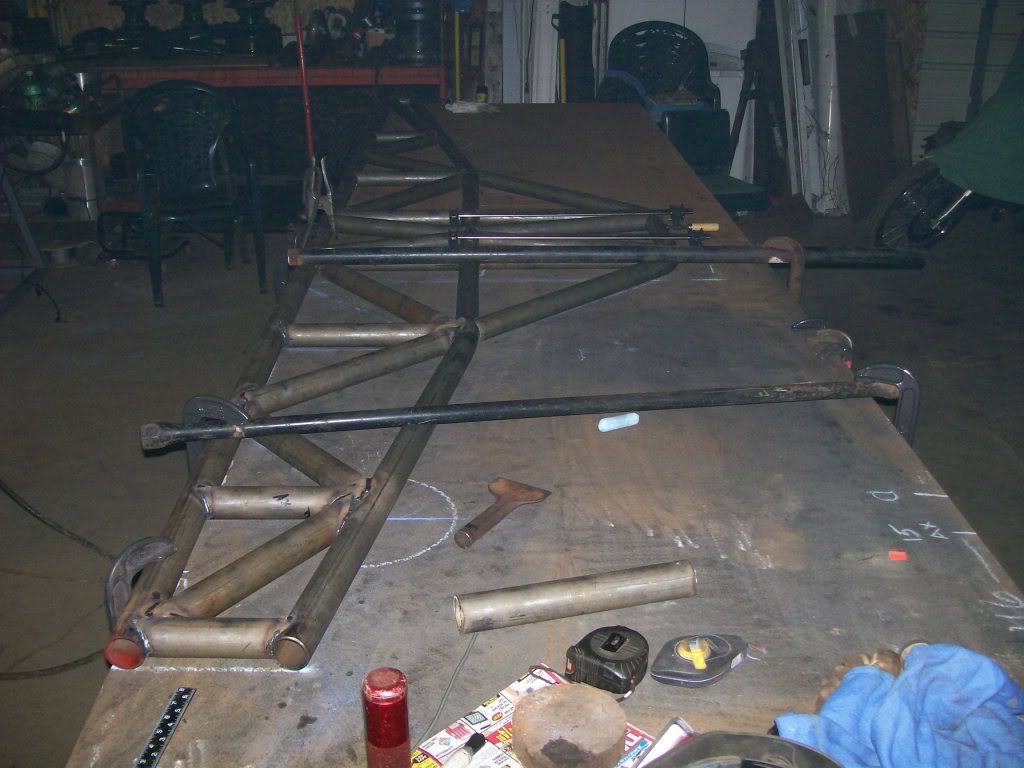

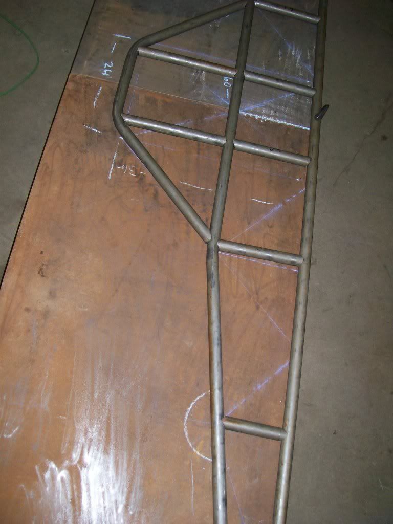

Finally had time to get started on the frame.  have been to busy with other things, but I did have time to build a 4' x 16' table to build off from. The table is framed with 3x6 box tube 7/16" wall and topped with 2 4x8 sheets of 3/8" plate.
Finish one side of the frame tonight and will start the other side tomorrow. One side was a 2 day project dam that was a lot of tube notching.
