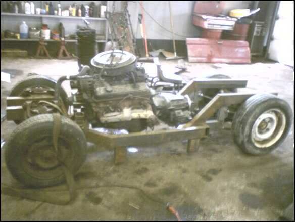

Working on motor and transmisson mounts right now.  Engine just dangling over frame to check out clearances and to make sure I have (barely) enough room to sit.

==kp so the motor is gonna sit in your lap an not where it would "normaly" go?
i would for sure get a trans blanket, esp straddling that trans, just in case

Econo-box from Hell
Quote from: J.C. on May 10, 2010, 01:20:40 AM
That's the plan since big Jim and the Twins are close to the spinny stuff.
==nw geoo ==wn
Econo-box from Hell
Quote from: 390JOE on May 10, 2010, 01:13:13 AM
Correct.  The car is too narrow to put the engine up front and still have some suspension.  Since my goal was not to use wheel flares to cover the tires, I opted to put the motor behinde the front axle.

hey  would it have been easier to extend the front end and fab up some longer fenders so the motor could sit farther forward, and in the center of the car, you know kind of like a funny car, then it would give you alot more room in the car for the seat. and some safety stuff so you dont lose a leg or foot or worse. just a ? going to be cool though when its done, just be safe first.
Econo-box from Hell
Quote from: Hammerlane on May 11, 2010, 04:49:19 PM
gonna want ta pay particular attention to the exhaust system too..
dumpin out on either side of the steerin wheel may not be your best option..
considering your carb is gonna suck every last molecule of 02 outta the cab.
The engine will be in a doghouse like a van so intake air will come from under the hood.  Exhaust will dump just in front of rear tires.
==nw geoo ==wn
Econo-box from Hell
Quote from: mudinvader on May 12, 2010, 12:40:19 AM
My goal is to do this without modifying the exterior sheet metal.  I march to my own drummer when it comes to building stuff.
