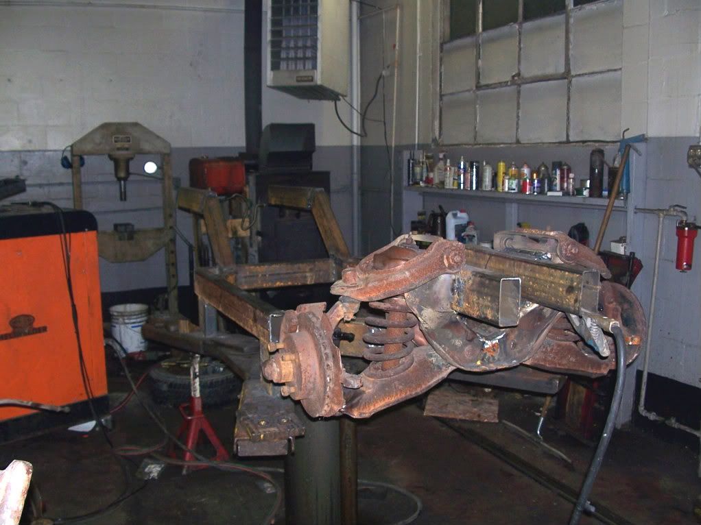

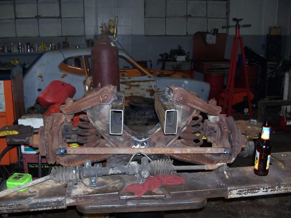

Econo-box from Hell
With the exception of fabbing up steering, the front suspension is pretty much done.  It took forever to get two stub rails situated so they were square, same length, notched for clearance, blah blah blah.
I stuffed the suspension under the car for mock up.  Everything is just eyeballed in so don't bust my balls about alignments.
The frame rails sticking out from the suspension are just stub ends.  I left enough material there to make my life easier when I attach the front suspension to the main frame.  I'm also going to have support for the body coming off the front of the suspsion.

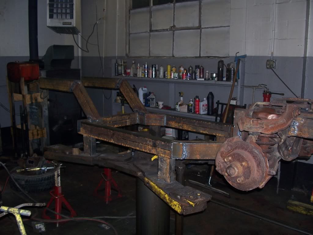

Econo-box from Hell
I have been working on the frame lately.  I have it welded to my hoist to keep everything square and level.

Econo-box from Hell
#75
Quote from: JR. on December 21, 2009, 07:04:51 AM
damn look at them bugger welds........
My welds never fail.  Anyone that has seen me beat what I've built will attest to that.
Some of the welds have been repassed with a tig welder to get maximum penitration at the edges.
I never claimed to be a great welder but with a grinder and some undercoating you will never be able to tell my welds from a seasoned pro.

Rollover Herb
==ogm
Quote from: Econo-box from Hell on December 21, 2009, 06:11:30 PM
Its all about the penetration! ==popn
loll
