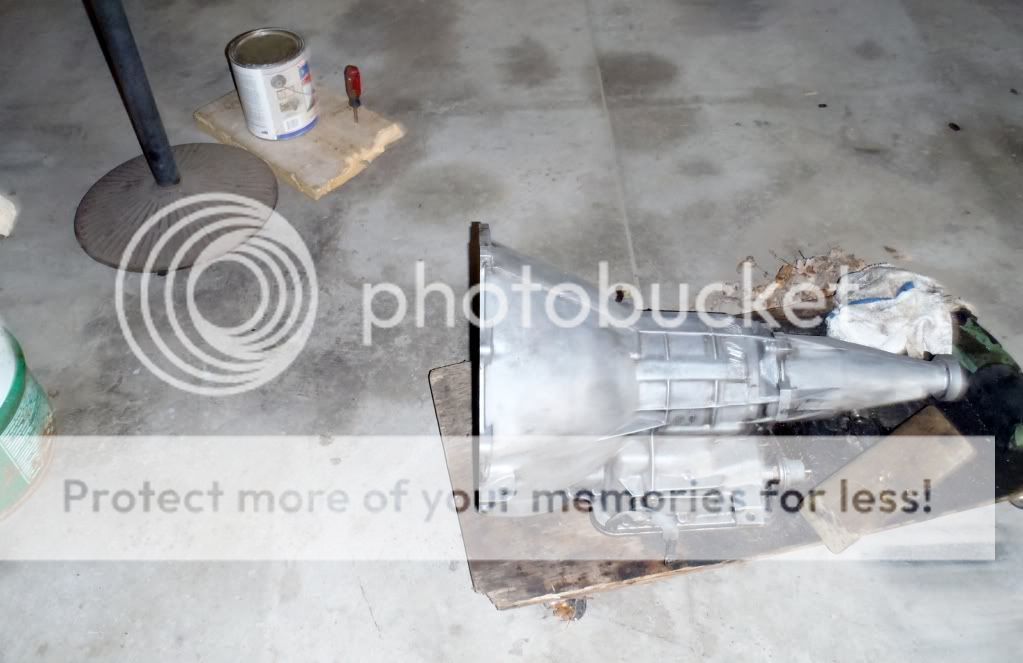

thanks all for the coments  its came along way  from what i started with    i was gonna buy a p glide yesterday at the midland swap meet but it made me nervous to buy a 500 dollar trans from a shifty lookin and actin fellow  id hate to change it and not be what he said it was or be junk and have to wait till spring meet to  throw it thro his truck window    2 weeks till the auto city racetrack swap meet hope to find some parts or somethin there did find out that the 6 cylinder p glides have a lower 1st gear and that happens to be what 2 of the ones i have came of fromso i guess that will be a good start ==wgm ==wgm ==wgm

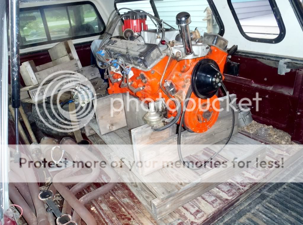

going to get the sbc  monday its a 383  that a guy had in a 57 chevy that a doctor bought and wanted a new crate motor  disc brakes and a bunch of stuff done to it   so threw some horse tradin my dad got it cheap  i just gotta do some work for him to pay it of    i  dont know any specs on it but  i guess its complete top to bottom including headers edelbrock carb and intake  pa  said its kleen enough to eat off from thant wont last hahahaha applaudd applaudd applaudd applaudd applaudd

gotta get it out the bag man lol  get it together  see what happens more power to turn those tires   still havent figured out this sb i picked up it got a 350 ballancer on it but a weirdo flex plate/ flywheel with a weight on it and some holes drilled half way threw it  i dunno  all about that but one thing i do know is it will either go or blow

Its prolly been ballanced as a rotating assemble, would be my guess..

Yup, Id say 4x4fun is right. I think you can do it that way, use the 350 stuff on the 400 crank and balance the whole rotating assembly - the holes drilled halfway through would be where they balanced it. Instead of addin weights they took some weight off.. Im pretty sure unless you buy some fancy rods, ya gotta grind part of them off or they hit the block or the cam right there in the top inside the motor. Makes for a low-end rumble that turns into a clanking sound and then the whole thing gets pretty quiet after that ==roll - I read some on it just now and I guess theyre sellin kits ready to go, we used to just make them in the machine shop.. Cool beans, oughtta rip!

I work in a factory making crankshaft pulleys for gm. The holes are "balance holes" without them it would shake your rig to pieces. Some of the more high performance gm pulleys are hot balanced all the way around the pulley then ballanced on just one side. The LSA's for super charged caddys weight about 18 lbs and theyre blanced under .25 oz.
