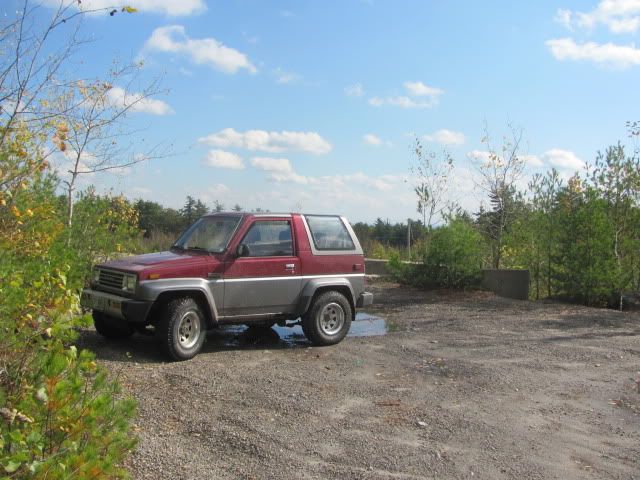

Those of you who know me know I have been on a mission for about 2 years now to acuire a rig without spending cash on it. (cuz I ain't got any) So far I have not invested a single dollar into this vehicle, its my extremely low budget build. 4Wheel & Off Road Magizine did a thing a while back called "Cheap Truck Challenge" where they had a max $1500 budget to buy and make capible a trail rig. I am trying to follow along those same guide lines. I am trying to trade for things I need as aposed to buying them. For example I might trade my block rockin' Alpine stereo system for a set of 31x11.5R15 Super Swamper LTB's for it.
It is a rare breed of trail rig and not many people have even heard of a Daihatsu let alone have seen one, it really adds to the WTF factor of the project. Everyone wants to have a cool unique rig I just took it to the next level and by luck I got one that was only made in the USA for 4 years.
Here are some stats on it:
Vehicle:
1990 Daihatsu Rocky SX
Drivetrain:
Daihatsu America 1.6 Litre Multi-Port Fuel Injected 4 Cylinder that makes a whopping 94 horsepower!
Dahatsu America 5 speed manual transmission and 3 speed transfer case.
Axles:
Front Toyota I.F.S. with Asian hubs, disc brakes, and either 3.55 or 3.73 gears (don't know for sure yet)
Rear Toyota solid axle, drum brakes, with either 3.55 or 3.73 gears...
Suspension:
Front stock torsion bars and KYB shocks.
Rear stock leaf spring under axle with KYB shocks
Wheels and tires:
7 1/2" wide Ford F150 steel white spoke wagon wheels with 225/75R15 Bridgestone Dualer A/T's
Other Stuff:
Fully removeable rear top section with hard and soft tops, removable roof section over driver and passenger seats, and wicked cool factory diamond plate front and rear bumpers.

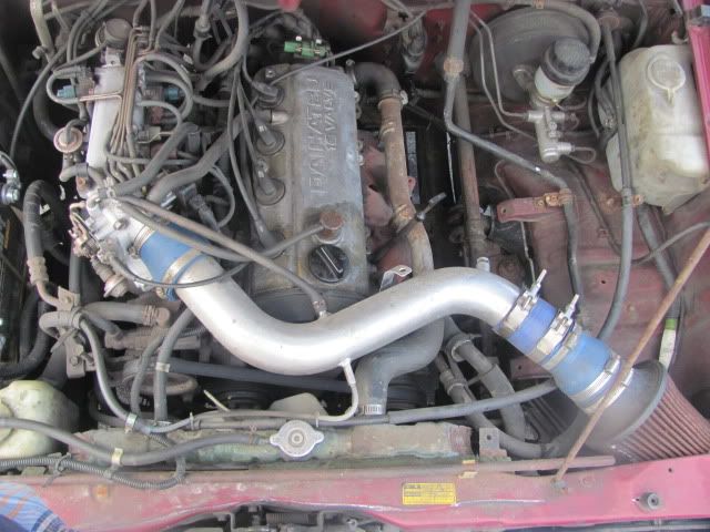

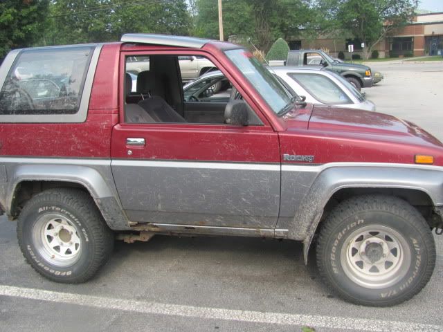

Since my last post in this thread I have added a Ford Escort ZX2 cold air intake and 30"x9.50" B.F. Goodrich All Terrain's. I got the intake for $20 and the set of tires used for $40...

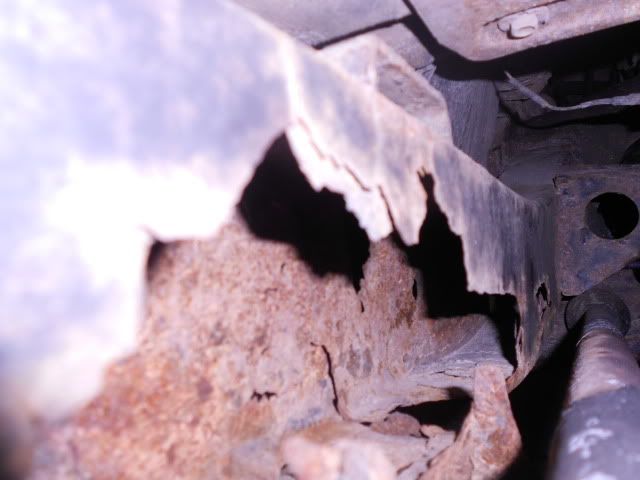

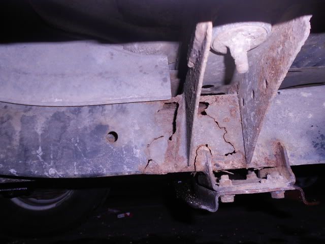

So I knew the frame of this rig was bad but I didn't know it was this bad...
This is the outside of the frame rail just behind the drivers front tire:
This is the inside of that same spot:
I can't fix this. :(
idk i had a nissan pickup just like that, I threw some big patches over it with some 1/8'' steel and a mig welder and some rustolem paint and its still together to this day and the guy runs it threw the mounds with boggers on it.
