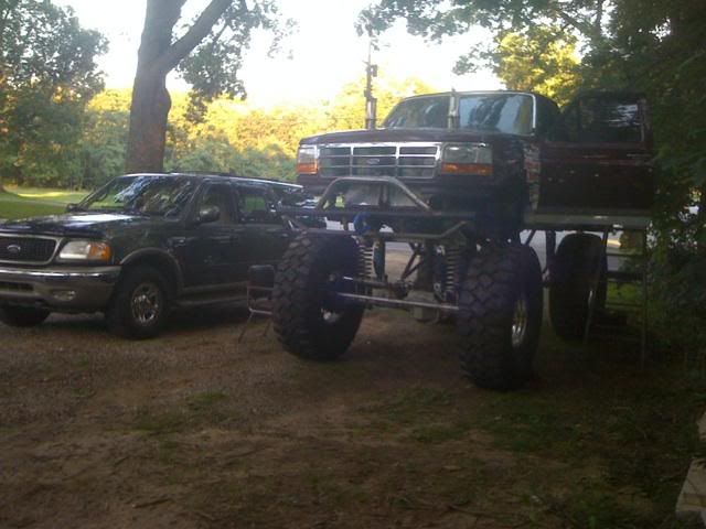

just traded my cougar a few weeks ago just wanted to know what you guys think! we ready to mud or what! shes not done yet but she will be ready for next year

SWEET. ==kp ++peace     YEA GO MUD IT

soon selling my other truck to finish this and get a trailer

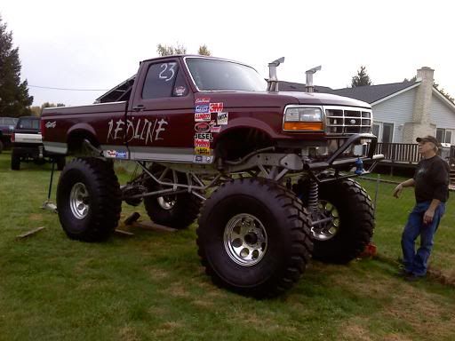

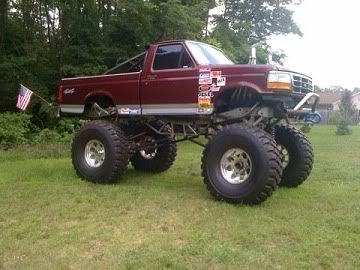

1996 ford f150 , with 53" goodyear tires, 20" chrome mickey thompson rims, dana 60 one ton axles with 5:13 gears and detroit lockers, rear has a welded pinion. Truck has a rebuilt 1973 460 with all kinds of goodies. upright (zoomie) headers,summit racing ignition system, lunati voodoo racing cam, rear mounted radiator with dual fans, rear mounted fuel cell as well as the battery, and transmission cooler with its own cooling fan. truck has raceway coilovers in the rear and custom front coil suspension, truck is all 4 linked, Has 4 point race harnesses with a full roll cage in the cab and roll bar welded to the frame in the bed. truck is setup for hydraulic steering just need to hook every thing up

that thing is wicked, looks tough as hell. good luck with finishing it up.    ==np ++peace

when did you get this? I think I knew who owned it..  good luck building it!

those are just regular uprights zoomies are just 4 individual pipes no collector but none the less deffinatly a nice truck

yeah they sound mean!

definetly bad azz lookin!

yupp i love the sound of uprights wiht a well built motor, zoomies sound good too but they only make good power on blower motors
