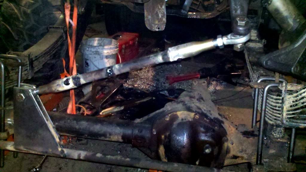

Something no one has mentioned is you can take off the tie rod end pitman arm and bolt on pretty much any other regular pitman that was on a Saginaw box.  I ended up using a Jeep pitman off a box I had laying around.  It splines on perfect and is right on for cross over.
I've also included pics of my cross over on my '97.  I'm a budget guy and didn't want to throw down the $$$$ for high steer arms and all the machining.  It was easy to build and works perfectly.  Lock to lock steering, no bump steer, clears the leaf springs easily(just be sure to use minimum of 0.120 wall DOM, otherwise you may run into flexing problems.........learned that one the hard way.)  At worse it may give you some ideas on how to build your cross over.

nice set up. never thought of doing it that way

pretty much wat the setup is is you have your tierod and u weld two plates on each side drill hole on each one run a drag link from steering box to these plate have a heim on end run bolt through. ranger wheeling mie has same setup on his f250 bogger look it up
