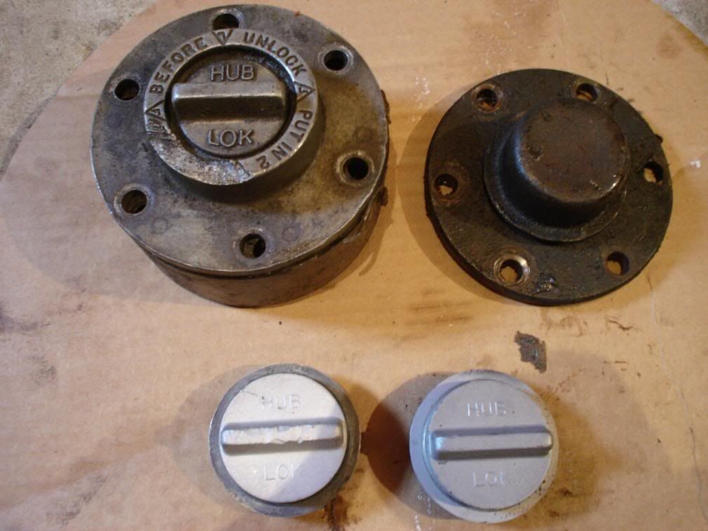

PRE 1970: 1969-back 3/4 ton GM 4x4s came with an all metal External bolt on locking hub with small turn knobs on them, these hubs were also used on 3/4 ton Fords of that era, and possibly some Dodges. Shown is a photo of the all metal locking hub...........a Full time drive flange used in mid/late 60's, (it was used with full time 4x4 in 70's also) The pair of metal knobs are 1/2 ton metal knobs, GM used an all metal 1/2 ton locking hub for pre 1968 trucks.

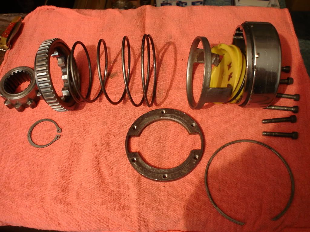

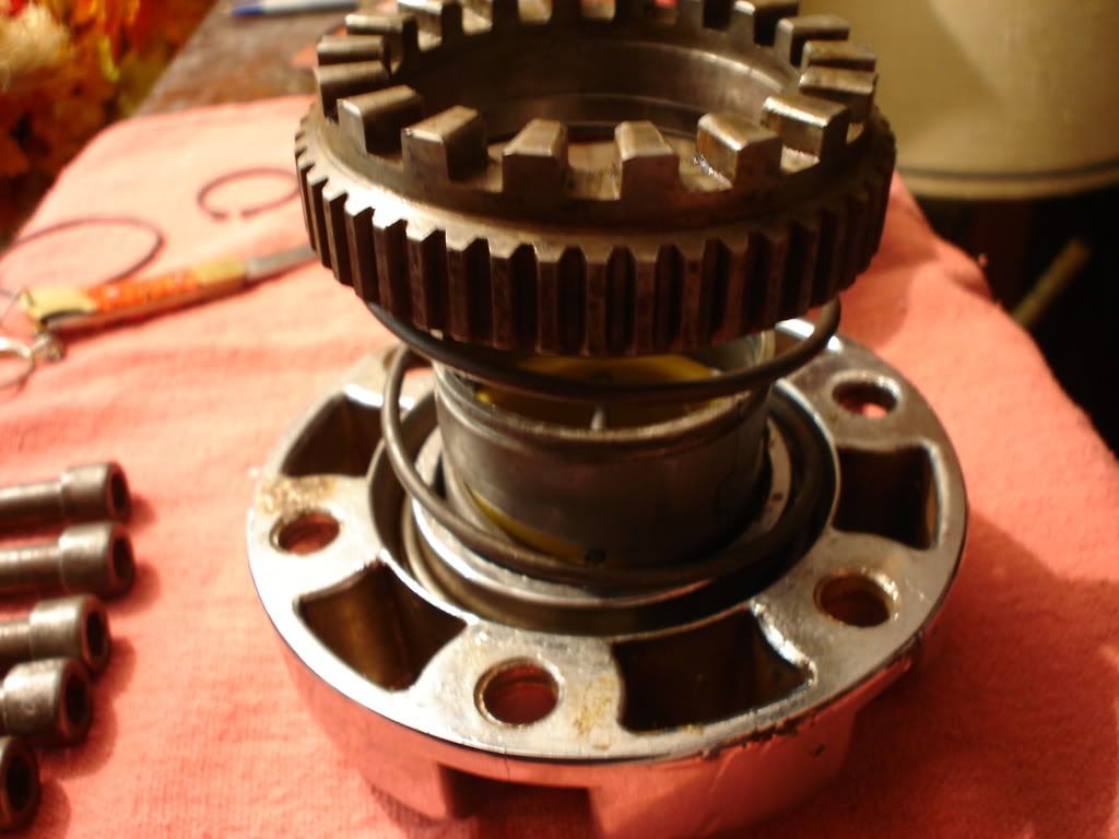

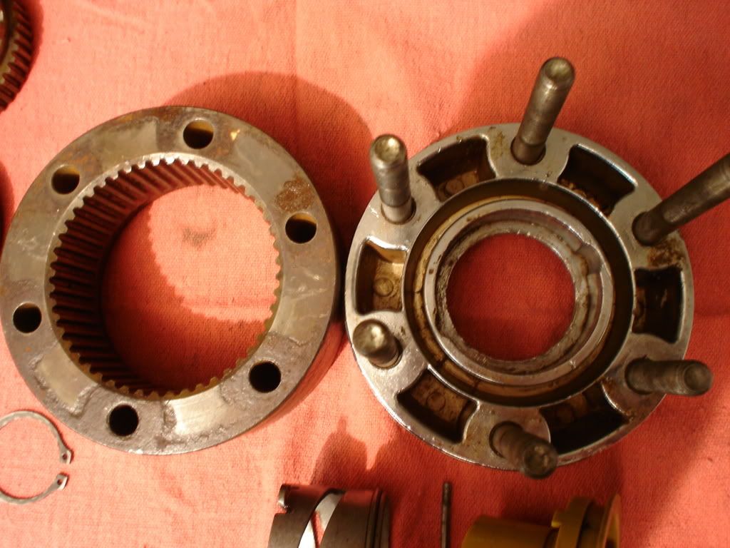

The Dana HD44 External Bolt on Spicer hub broken down for detail:
The coil spring is also massive in these.......compared to later style Warn hubs.......see comparision below.
Notice the size of the allen head bolts, they are extremely heavy duty.

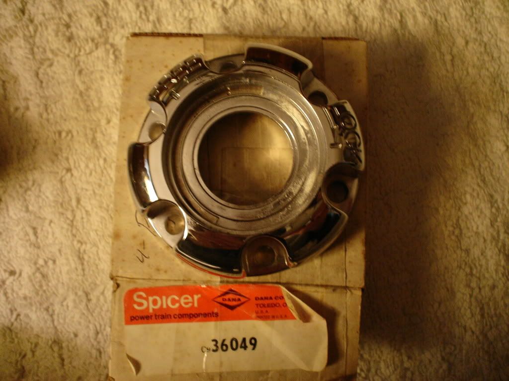

Here is a brand new Chrome outter housing.

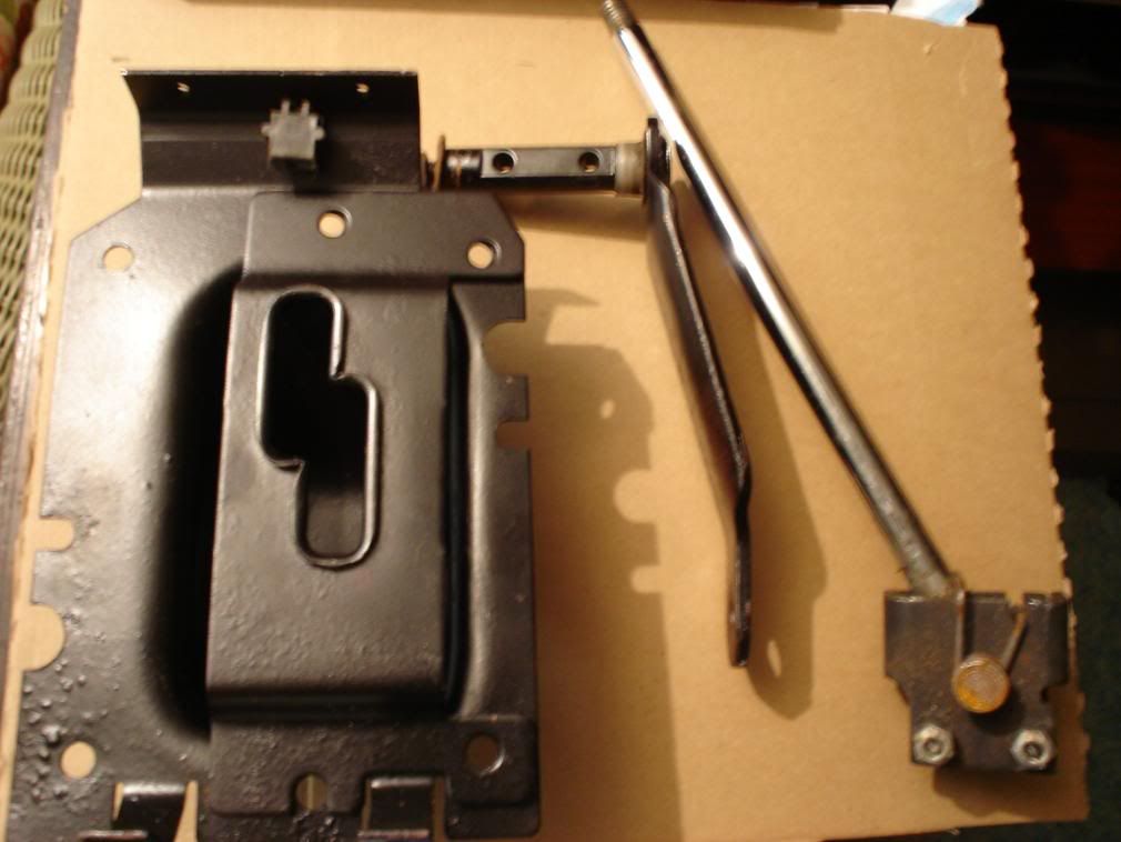

NP208 Levers: GM used only 1 style of lever......they were all chrome plated.........I am showing pics of the lever housing & upper linkage arm as well.
