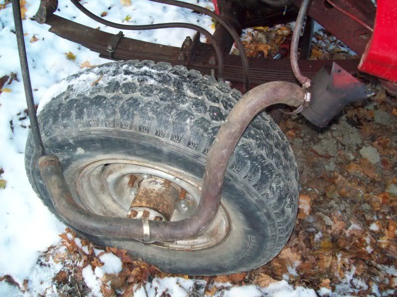

Heres a picture for refernce from when i was tearing my s10 apart...
#8
Eroq is tellin ya right, and looks like hes been down this road before - Id go with what hes sayin there ;D
