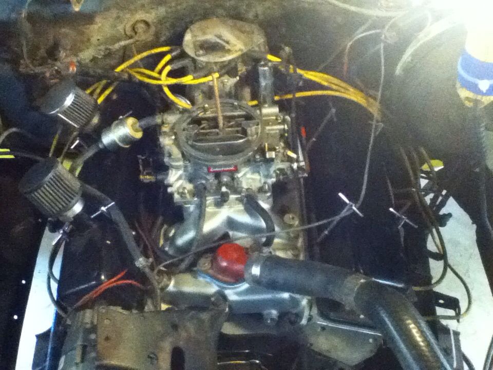

Stayed up till 4 last night got it all together... Woke up started it, timed it, lashed the valves, modified my valve covers and put a few other things on and was on the trailer at noon to jarmin.. As i was leaving i got a call and i only had enough time to play about an hour an a half... Figured out a few minor issues but other than that i cant complain about anything new ive put in it... Ill upload some videos later and some pictures

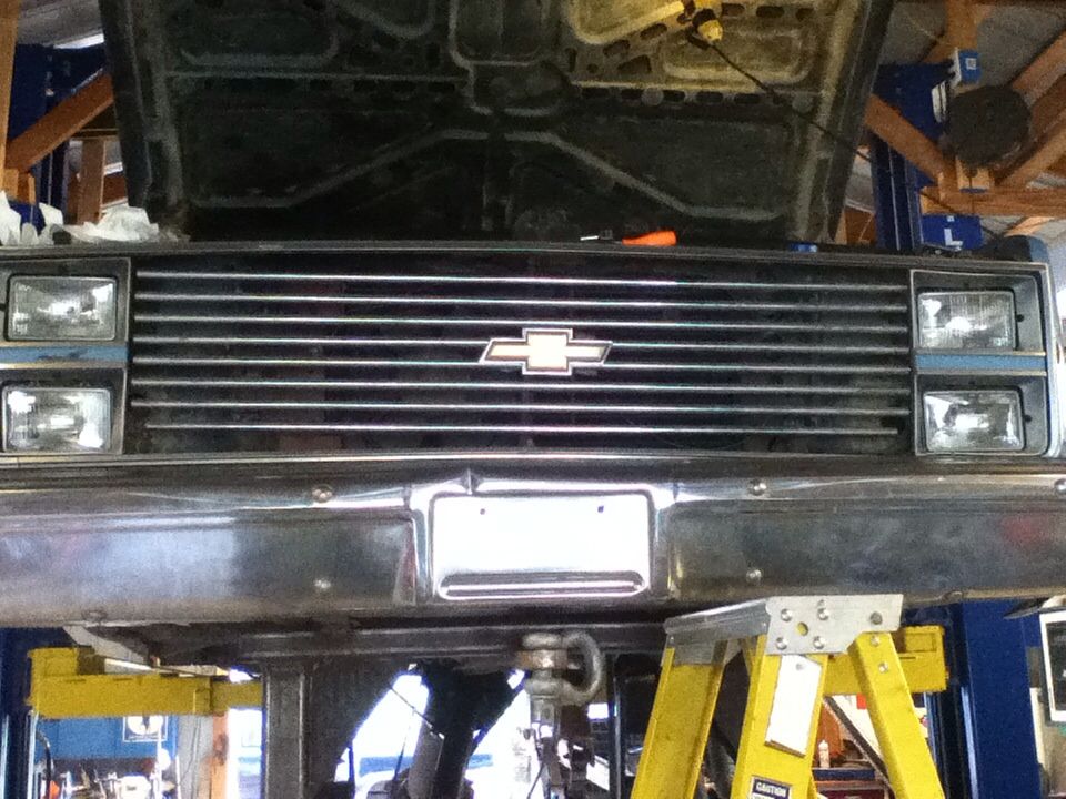

started it the other day and found it to be running like p00. thought my carb needed a rebuild, so i rebuilt it. still runs like p00...come to find that im sucking air between my heads and intake. ordered everything to fix so tomorrow night itll be good again... but today i finally put in a grill in that my dad said i could have if i could use it, and an electric fan he had for a spare for his jeep too  ;D i love the guy hes the best...... who says you cant use a grill from a 1977 k10 in an 1984 k10 loll
84silverado
Been awhile so i figured id share what i did to fix my air problem. I bought a dart intake with 215 cc intake runners so it would fit over my heads 210 runners with ease. Runs like a champ now that it isnt starving fuel or sucking air from the wrong places. Havent had a chance to run it yet but i need to cause i leave the 31st for bootcamp!!!
