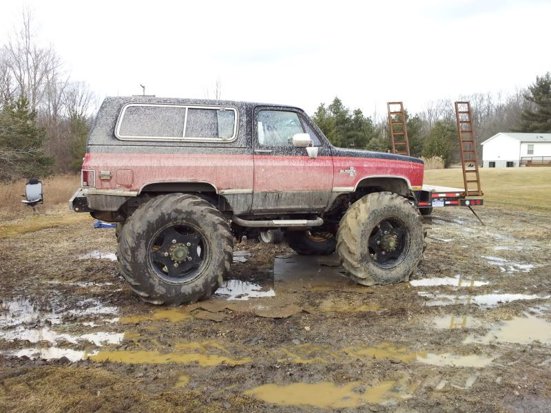

Couldnt resist.  Had to have a little fun today.
U gonna cut more fender man?  It looks pretty close on the pics
Quote from: Blazin40s on March 05, 2012, 02:44:35 PM
Yeah, that was my plan yesterday.  Didn't happen.
Finally got the power steering pump pulled, now to put the new one in.
Got the trans to tcase shaft pulled.  Need to either sleeve the trans output yoke, or just get a new one.  It was leaking like crazy.
Finally got out and did some work.
Get the new trans yoke in... seems to have stopped the leak.
Power steering all hooked back up.  Definitely need a reservoir and a cooler.  It got real hot.  Like steaming hot.
Also have to decide on what to do about the clearance.  Either  trim a LOT more or more springs.  I really dont want to do more springs though.

Well, one wheel pulled off.  I hope to get the other three off tonight.  Then take the wheels to get the other tires mounted.
18.4s here we come.
let s see your new tires   any taller ?
Quote from: Captn. J on December 12, 2012, 03:05:34 PM
They are waiting to be mounted.  I will get the pictures when they come home.  Probably about 4-5 inches taller.  I need to remember to take a measurement.
