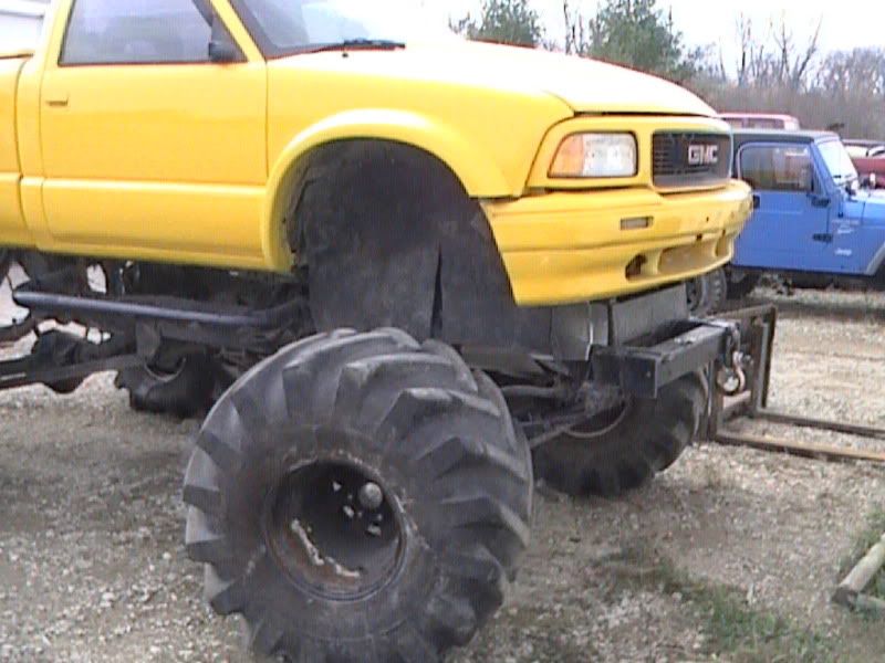

Thanks guys. It's been 4 years getting to this point from a body an frame. I'm tryin to get it done for tgw in Romeo May 5 but I'm not sure it'll make it. I refuse to cobble it.

The writing on the side says "No fear  No doubt  All in  Balls out". It's for backyard and comp bogs. Big Al, that's where I first saw that size. I love em! After I cut them, they were even better and lighter than a 44 bogger!

* Question *
I'm guessing you cut and flipped the diffs, for the direction change ?
If so, your not worried about running on the backside of the gear....with "ALL THAT " Power &  Traction ??
Not bashing buy any means.......I'm very interested in the answers......Heck..if it works...dont over think it I guess  applaudd

Yup, you're thinking too hard there mudbilly. The quality of the components, the way they were assembled, the weight of the truck ( which is well below 2800 lbs.) The pinion an ring should live just fine. And worst case is that they fail an I rebuild them even better next time or I put in the rockwells that are sitting next to the polebarn, but I'm betting my truck will run just awesome. Just like my other trucks do.
