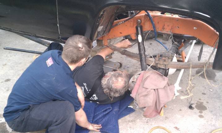

was planning on putting on some ladder bars for the rear! not sure if its easier/less expensive to buy from store built or just fab some up.. i have a fab guy im friends with down the road but havent spoke to him about building some yet, just thought to bring it up and see the best way to do things. was glancing at kits on jegs so far.  and is smart to install one? thanks guys
#37
Just make sure they allow the suspension to travel and doesnt fight the springs.  The center point of the springs doesnt just travel straight up and down, it is a slight arc.
Newbie
ok im seeing lots of other ways to do this.. lol thanks for the info ken. im gonna keep on reading and seeing other peoples set ups!
