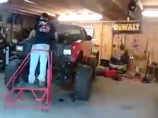

got alot done this weekend..
re did spring perches, got both axels bolted in for the last time, got steering set up.
and got ALL my break lines hooked up, did away with elec set up went back to an proportional valve..
just a few snags.. missing a caliper, found a hole in my gas tank,

Well got all the breaks done and bleed..got the rear end parts in and on got d shafts hooked ...along with some pittly stuff fuel pump in and thermostate stuff. Just got done fab up the radiator..tomarow brings plug wires some liquids and a test fire

Did test fire motor let it run for a few..  Felt great after all this time to hit a limiter again
scooterbob
well kinda slow progress.. but i did get it running, and taday i moved it for the first time on its own!! so awsome it was
did a burn out in the drive way, and smoked out my neighbors garage sale..lol  he didnt look happy
need to finish front bumper now,,,exhaust, paint it ,,then finish some wiring for the lights.. well see if it makes this season so close
