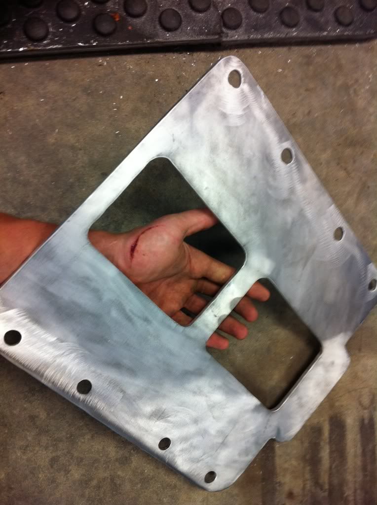

My old man did the dual ram with roots, pretty simple. You just make an adapter to fit the ram with the blower bolt pattern, and put carb spacers or injector spacers under the adapter.
Here's a plate I made to adapt my large opening manifold to a standard opening blower

Jthomas
So you would have to weld the spacers to the opening on the plate, then it will bolt right to the dual ram.

Jthomas
Weld this to the opening of the plate. Then it will bolt right to the top of the intake.
Bam, then ur done

Jthomas
Best way to make a plate, trace the base gasket on the aluminum plate. Cut it out. Set the blower on top, punch the holes, then drill.
Make sure u use aluminum bolts on all aluminum pieces, cuz good luck getting steel ones out. But you won't be able to use blower studs, unless you used really thick plate. $$$ so you will have to bolt it, torque the blower to 17ftlbs. I've herd 15-20 ftlbs
Once u weld ur plate to the spAcer, it's just a matter of bolting the spacer (which is now welded to the pate) to ur intake, then bolt the blower to ur plate.
