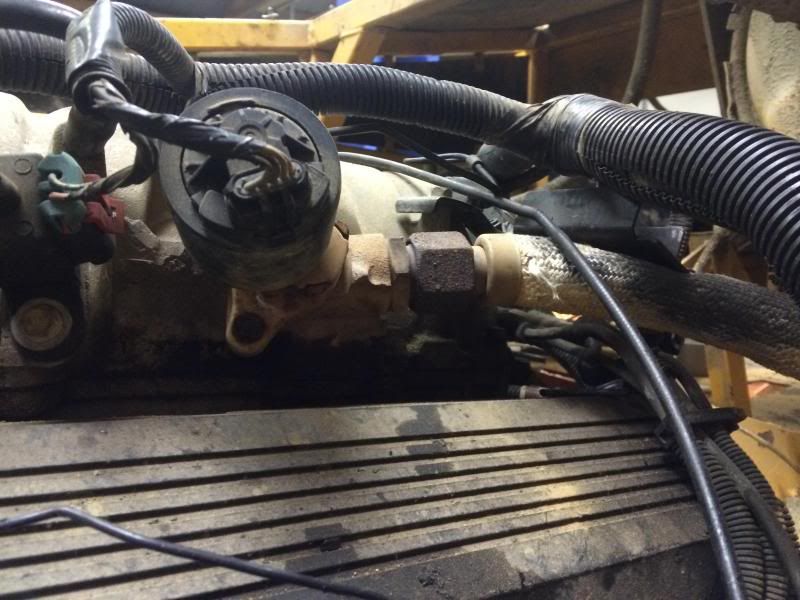

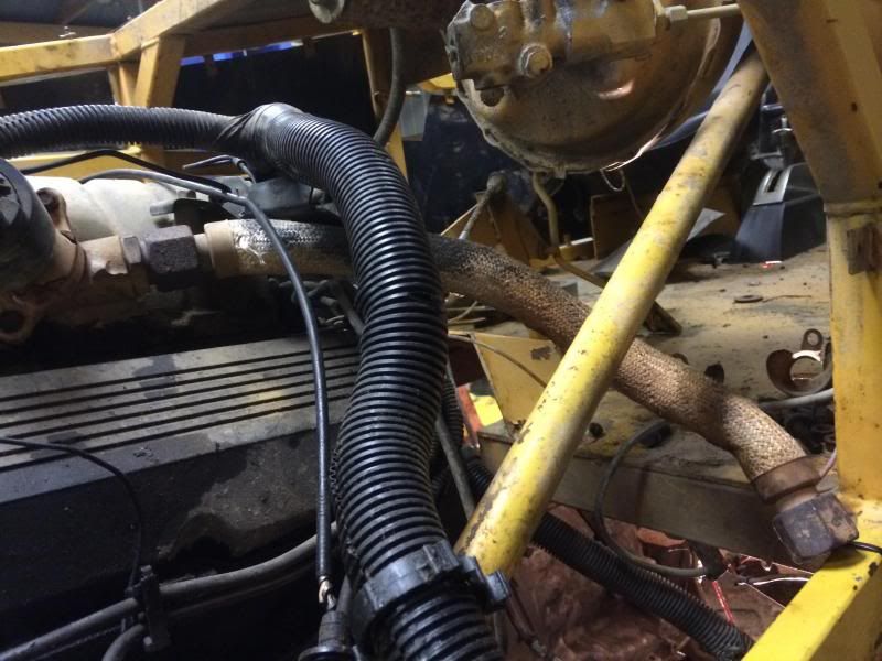

need answers , here s more questions   this heat tube goes to the stock manifold and i m planning n hoping to use uprights so what can or should i do w this tube?
[url=http://i27.photobucket.com/albums/c161/beaver22/tube2_zps0fada959.jpg][/URL]
[url=http://i27.photobucket.com/albums/c161/beaver22/tube_zps4873c3f8.jpg][/URL]

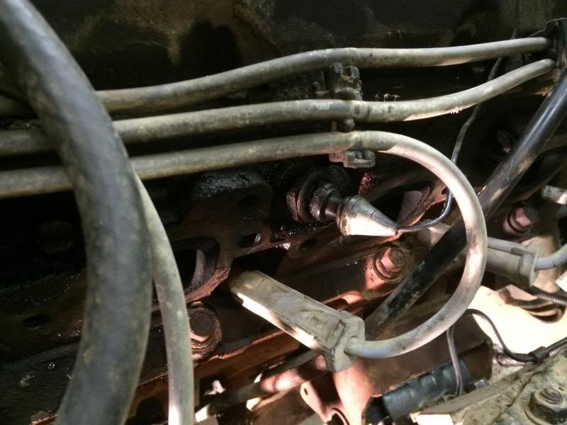

also need to know what sensor is this ? about the spark plug and near the valve cover? cuz one of the plug broke  want to be sure what it is?
[url=http://i27.photobucket.com/albums/c161/beaver22/plug_zps37187b95.jpg][/URL]
One near the spark plugs should be temp sensor for a gauge. Usually drivers side head

Looks like a knock sensor, from the way the connector looks, pull the plug and take a pick of the connector, temp sensor is almost always 2 wires on it.... as for the tubing....its hard to tell from the pics....but I'm guessing part of egr system or air injection pump.....cut it off and plug the holes, it won't hurt anything

Did some more looking around....it is the CTS,
Cts? Which?  And the knock sensor is way down there. Not the pic I gave
xjs3667
Coolant Temp Sensor.....the sensor in the pic in the head by the plug.....being one wire, I'm pretty sure it goes to the ecm
