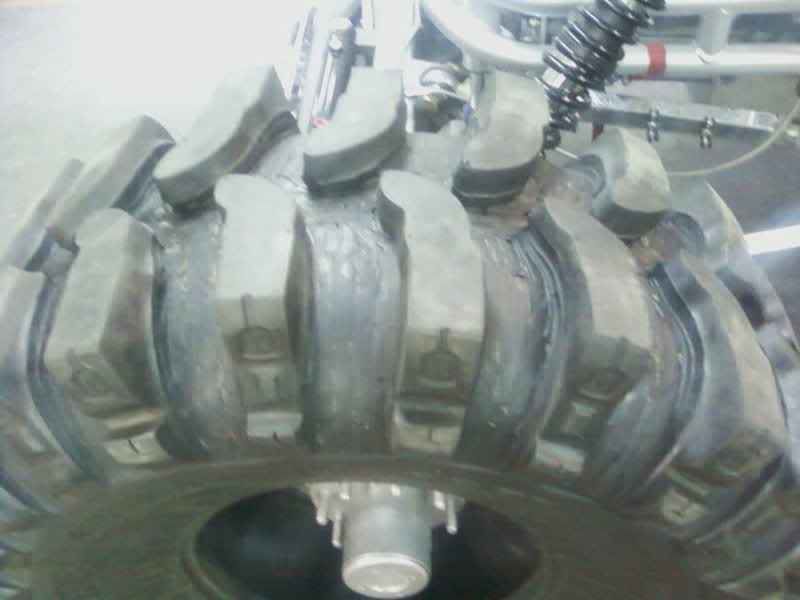

i took 3 lugs out then skipped 1 then 3 more out on my front 38.5s definitely recommend sanding down the grooved sections, makes them look so muck better.

Man that looks mean! I took every other lug out of two of my hawgs, and it definately worked however the lack of surface tread caused a rapid tire wear.
My next two I just took half of each out, won't wear on the tire as hard.
night train 2

my trucks pretty light about 3000lbs, they haven't seen pavement yet.
