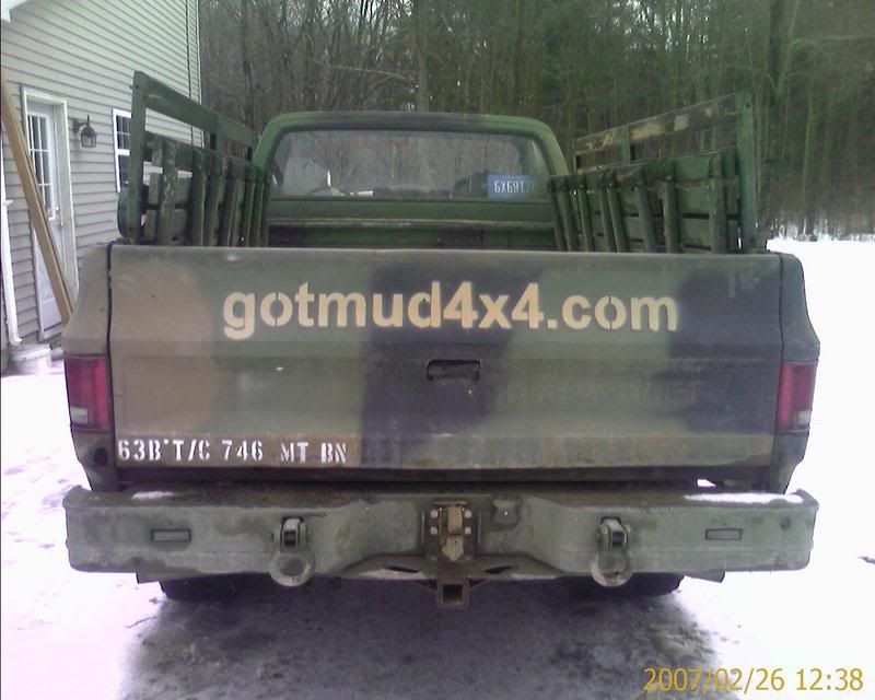

Rear on my Jeep is a 8 inch peice of Channle  with a Hitch cut and welding in to it then welded all of it to the Frame.

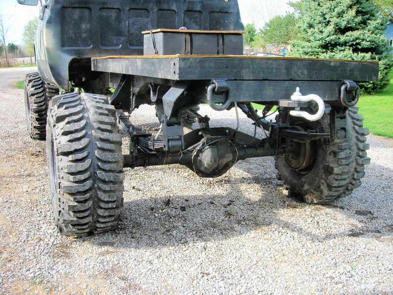

front will have two 20000 lbs d rings and reciver tube welded into costum bumper and grade 8 bolts, rear two 20000 lbs d rings right at frame points reciver tube weld into costum bumper grade 8 bolts

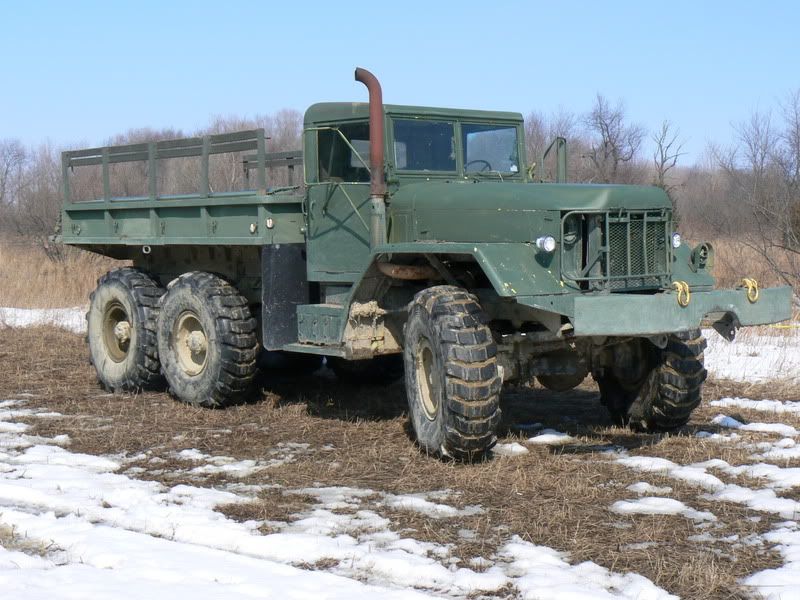

oooops I re-read this and forgot to say that my towpoints are military

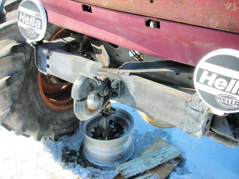

i have 3/8 c-channel from side to side with 3/8 plate in between that c-channel that you cant see in the pic. then i have 4 braces going back tieing back into the frame. the angle iron dont help much but its welded in real good. you also can see that i bent the frame around the main peice of c-channel for the heck of it. i got pulled out tons of times by it with no signs of bending or cracks in the welds
TOMAC
older pic. the rear is 1 or 1 1/8 thick  cant remmber off hand but that is welded and bolt with grade 8 bolts and what you cant see that have 3/8 angle iron tied farther back into the frame.  that is all attached to boxed 3/8 thick  square tubing. its all welded up tight. and the d-rings welded real tight. a guy and 44s was yanking one of them and another guy on 40s was yanking on the center at the sametime!! with no troubles :)
