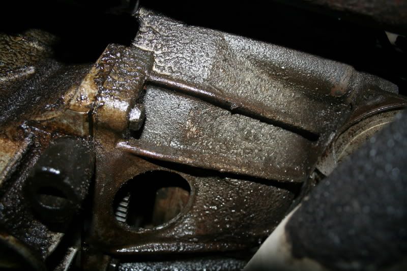

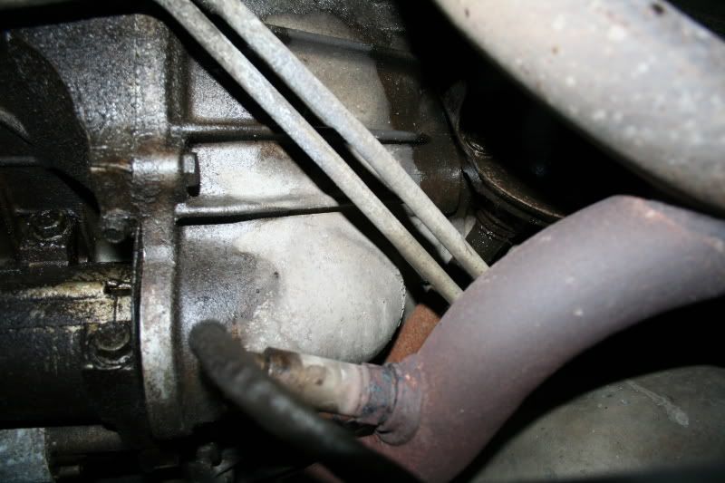

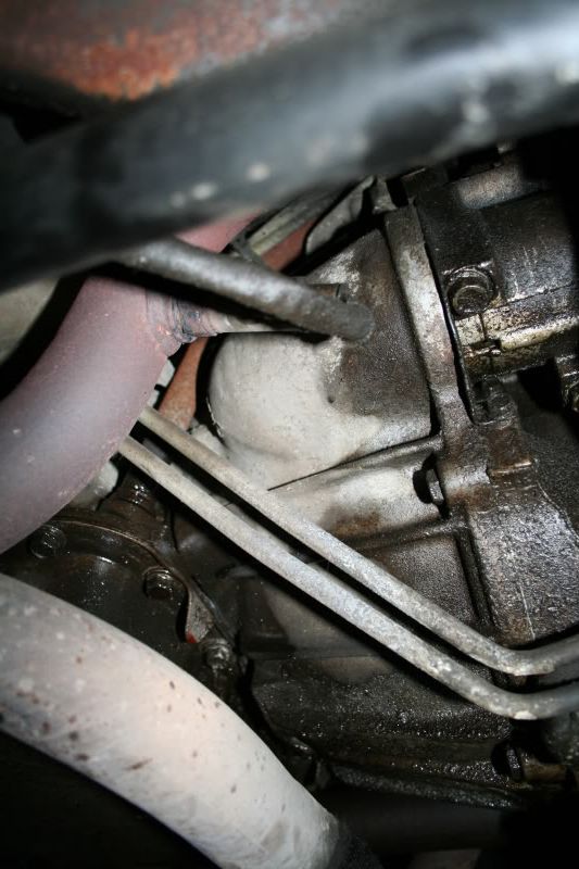

I am getting ready to finely pull the engine from my wife's 96 s-10 blazer 4-wheel drive with a 4.3. I got most of the stuff done except unbolting the torque converter and that's where I am stuck. According to my Chilton there should be some brackets the run from the trans to bell housing bolts and none to be found. It also states that there is a flywheel access cover to remove after said brackets are removed, again no go. What I have is a solid cast alum. bell housing with 2 small round pop out covers. They nether one allow me access to the bolts. Do I pull the torque converter with the engine or is there something I'm missing that Chilton is not telling me? This is not my first engine pull or rebuild. Please help me with this as I'm about to fix it with a stick of dynamite. Thanks in advance.

thats the thing there is NO inspection cover it is solid. ill get a pic of it

Oh I thout that would have still had the old style belhousing but it doesn't can you go through the starter hole ???
wirehead80
ya know i never even thought about that. im going to give that a shot.
He is correct.  That is the only way it's comin' out.  The top bolts on the bell housing are a stinker to get and there are some ground wires bolted to the back of the passenger side cylinder head too.  Its a tough job but you can do it.

to get the torque converter bolts you need to pull the starter, and access them from the front of the motor...
