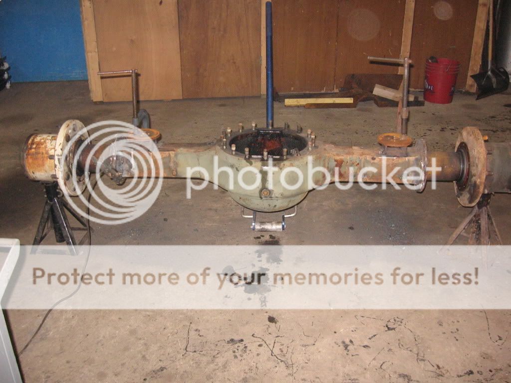

Slowly but surly im making head way. I got my front axle finaly and got both axles debraked. To give you an idea how much wieght i lost on these axles by debraking, a drum wieghes in at 90lbs and the backing plates and shoes at 68lbs. it adds up to just over 600lbs in fat removed. I have also been working on building my new rims, i have one more rim to clean up so i can start welding in the new centers i made out of some old semi rims. I'll try to get some pics up in the next couple days. Trout

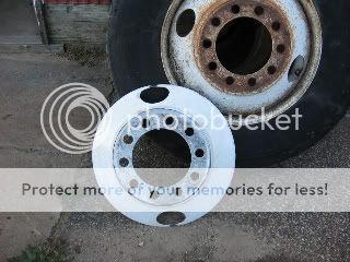

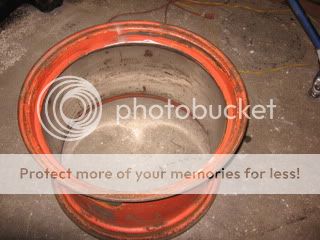

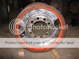

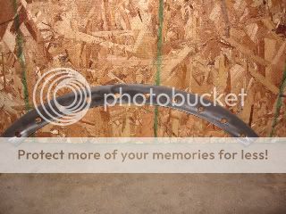

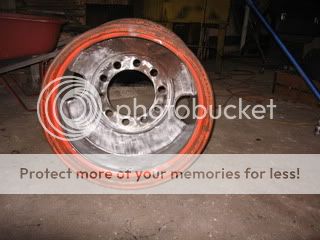

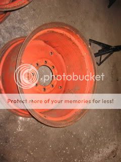

I liked her to, she was from oklahoma and was 18 at the time. her first cover shot to. What sad is its sat in its trailer for 4 years now gathering dust. now on to some update pics. making 15x24 5ton rims. Total cost for the new centers $60 and some time.
What i started with
the 24.5 rims i cut down for the centers,
The center removed and cleaned up,
The rims with the centers tacked in place, 4" of back spacing,
Still need to sand blast and powder coat. until next time Trout

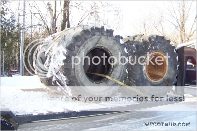

blazentrout
Well, i got 3 66" tires sat. now just need to find one more and some rims. any leads?

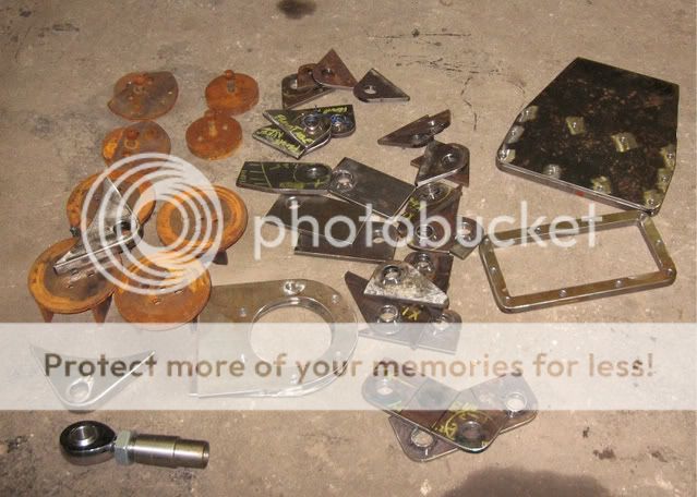

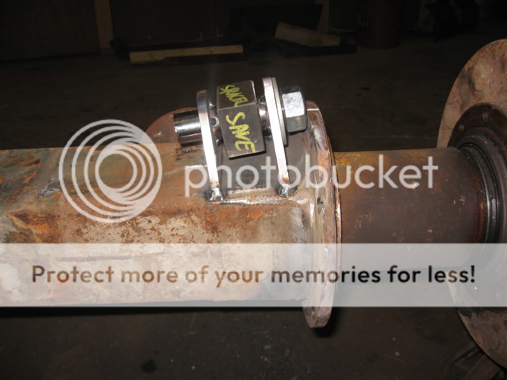

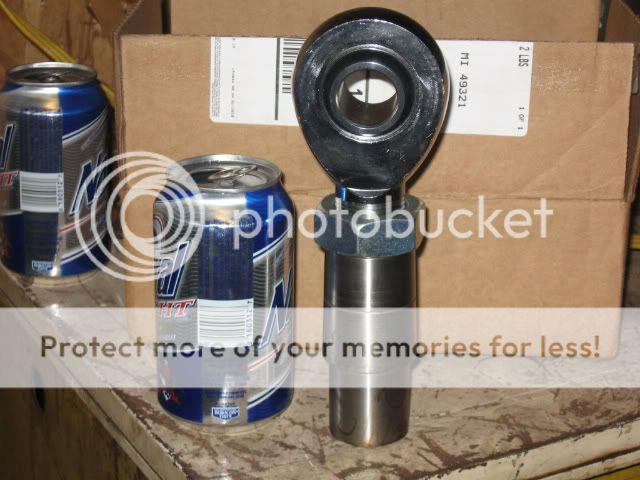

been working on it a little, my hiems
some brackets,
a couple of axles shots,

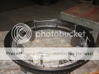

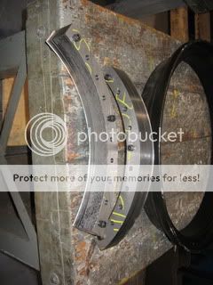

and heres a couple from my rim project for the 66's
Yes. i am building a set of true 2 piece bead lock rims that should be half the wieght of the stock ones.
