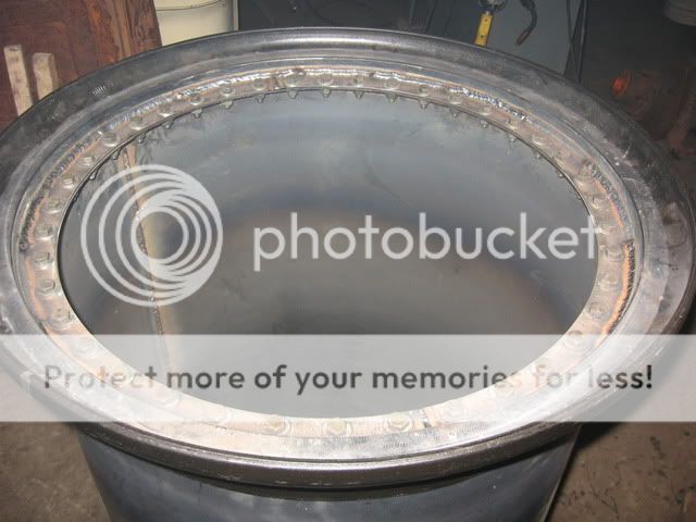

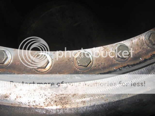

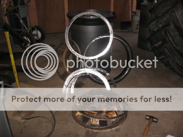

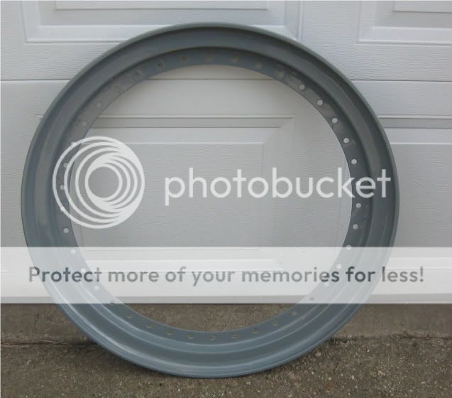

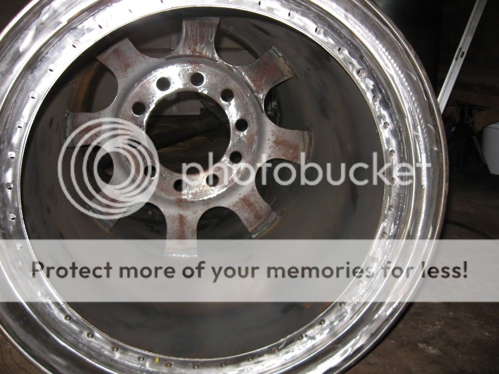

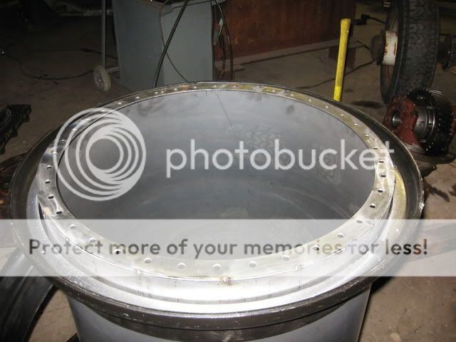

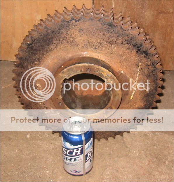

Like i said, i work at the speed of dark, but on in to the night i go. Here are some more picks of the rims for the 66's.
A pile of parts,
retaining ring tacked in place,
outer ring welded on
close up
2 down,2 to go
Still need to  put the centers in and clean them up, but so far so good.

i'll wiegh them when they are done, but i will wager that they are 160 to 180lbs lighter a piece than yours. My 24x15's wiegh 92lbs a piece. and i know the flanges were 42lbs each and the centers are 31lbs. i did not wiegh the tube before i started but i dont think its over 50 lbs wich puts me about 165lbs compared to 380 to 400lbs for the stock ones.

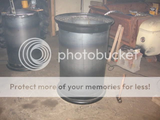

well, not much has happened, but people like pics

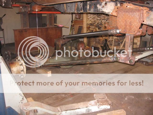

rear link mock up
rim center welded in
some color
The small tires done and mounted- still need to cut them yet

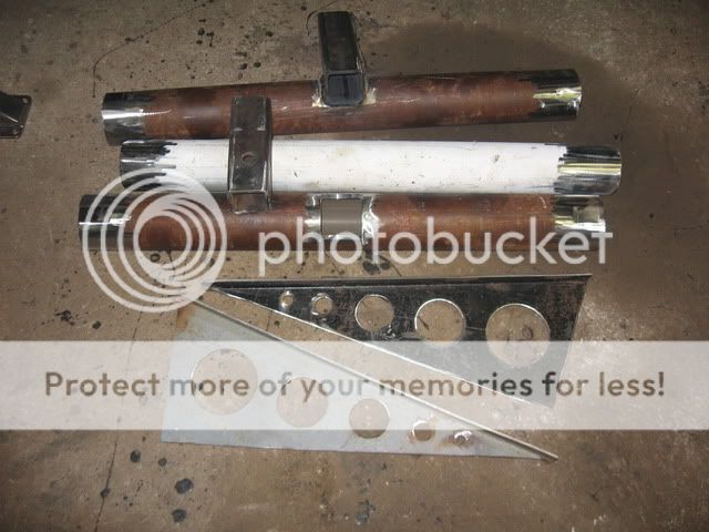

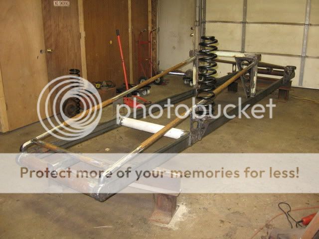

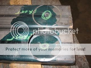

Well, i got to thinking on how much welding/grinding i was going to have to do to box and fill in the holes on the frame, so i got stupid and decided to build a wilman style frame. here is a teaser shot:
