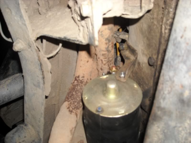

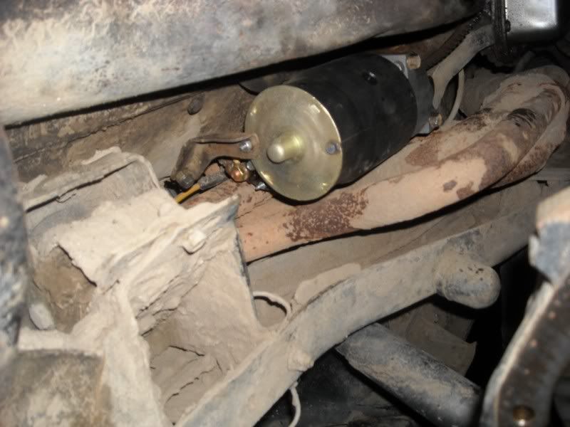

chetney
heres best pictures i could get
==cl Sweet, that helps alot. Now I can put two and two together. Never saw one installed before. I think I'll grab one like that. Do the other ones attach to the same place? ie. can I mount more than one brace for extra insurance?
if its the  right one  you olney need one,  chetneys  was grinding  everytime  it tryed to start. it don't do that  no more.    it  don't shake all over  no more.

the stock braces MAY not work with your starter since you said you've got a mini starter but now that you see how it works do what I did and get a piece of 1/8x1" flat steel and put a bend and a twist in it along with a couple holes and your good to go....  ==2cents

just make  sure  you  good and tight,  you shouldn't need  any  brace on them,  but if you do   you  mite have to make your own.
