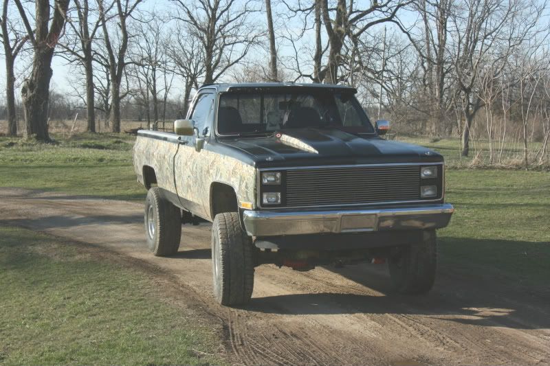

ok my 87 k5 has a 3'' body lift. (was like that when i bought it) anywyas the front sits lower than the back. why is that. all the blocks are 3''..so why dose the back sit up so much higher? is there a way to fix this?

well i know its not the mounts. theres no rust under this balzer and all the mounts are solid as a rock.  i did just notice that the front springs are slightly slouching down. they should be level. so im pretty sure i just found the prob. thanks guys!

I want that Grill ==roll That looks good...would look even better on mine  ;D

I dont know then? I do know I want your grill  ;D
lol if i had another id give it to ya. i searched along time for one of those. it was white and full of rust when i found it.

Those grille's do look sweet.
