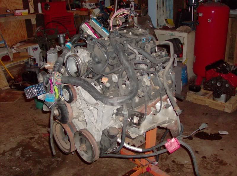

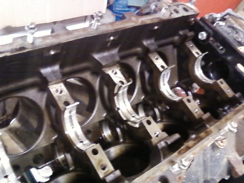

==cl i like that extra pulley there ontop of the intake... ;D ==djdj
Fraser
Quote from: littleredbicycle on July 07, 2009, 10:50:28 PM
Wat? i see a throttle body. w/ oil in the bottom of it
Groundhawger
i was thinking the same thing
Yeah i was seein things lmao one of those days.. ==kk

yes, it's a 5.3. the plans are to bore it out to a 5.7. or maybe leave it stock, depends on the cash flow.
computer is already taken care of. custum tune to eliminate the vats, egr, o2 sensors and a few others for the price of $300 from nelson performance in texas. building my own wiring harness to save $400, uhm.....fun. LOL
i grew up with FI unlike most of you carb guys, so i'm going with what i know how to work on.
oh, and did i mention 6 bolt main? ==dj ==dj ==dj
mudseeker
#8
4 top bolts and 2 on the side

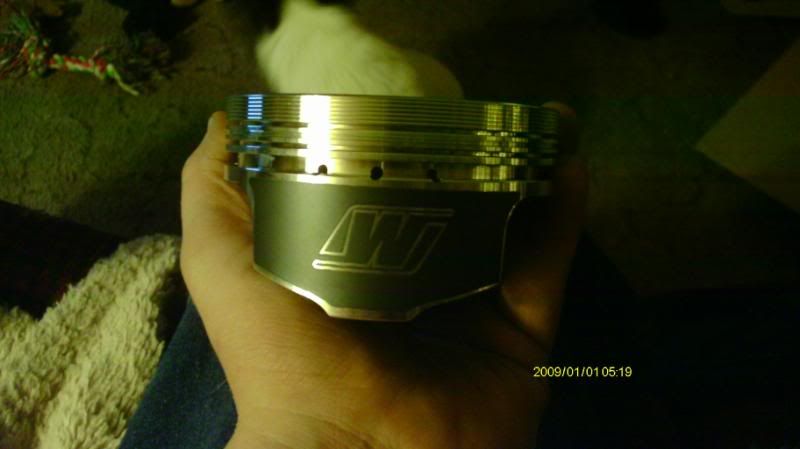

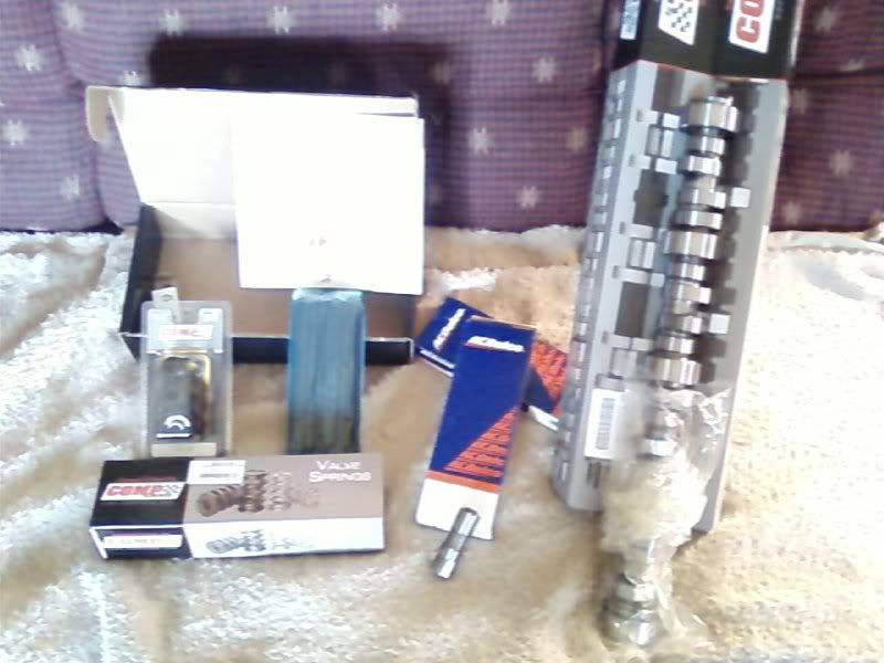

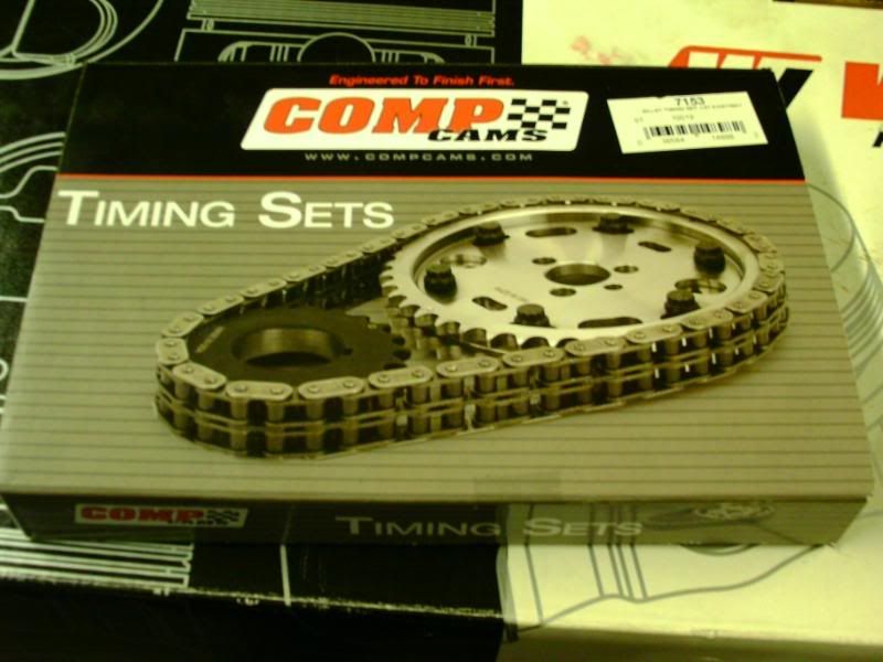

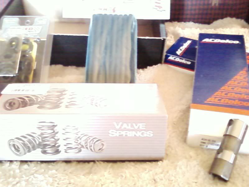

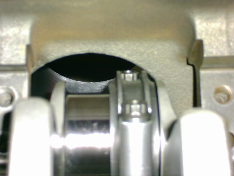

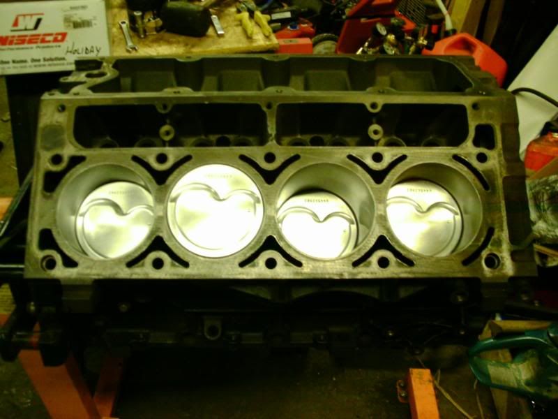

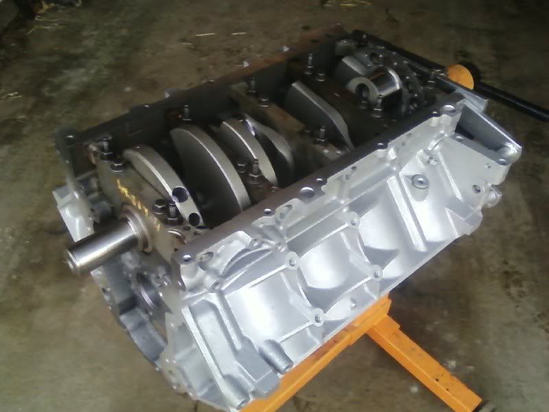

wow, seems i need to update this thread since so much has changed.
the 5.3 (325ci) just got dropped off at Reichert engine in owosso to be bored out to a 5.7 (350ci)

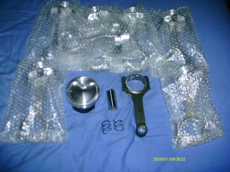

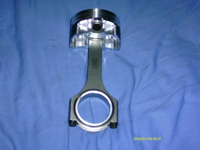

here are the plans to make a third gen chevy 383:
a forged 4inch stroke crank from K1
forged 6.125 inch K1 H beam rods

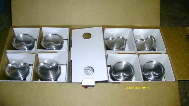

forged aluminum -12cc wiseco pistons

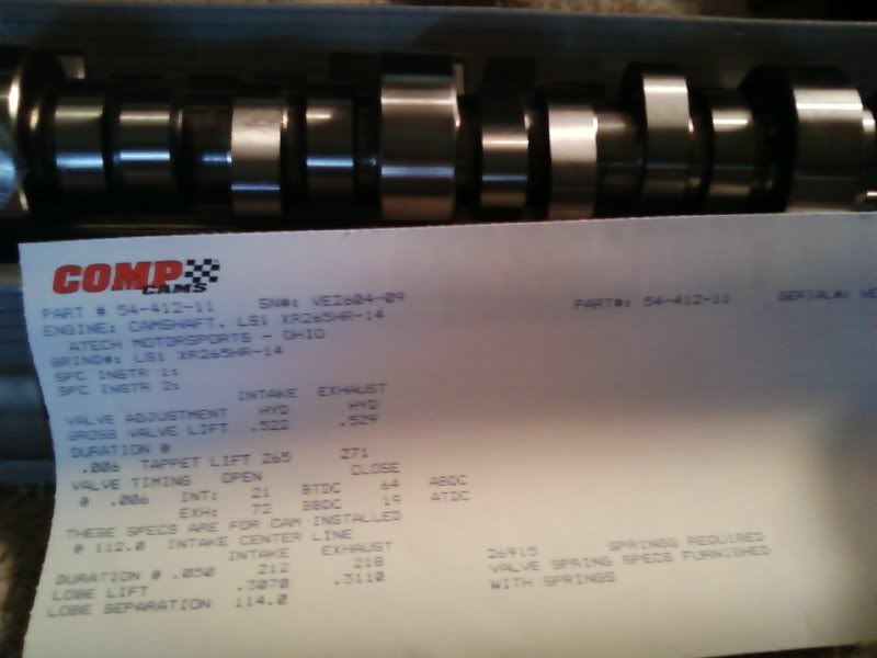

comp cams xr265hr-14~ .522/.529 212/218 at 50% duration
comp cromoly pushrods
comp valve springs
GMPP roller lifters
ARP bolts
much more i will list as i build.
on to the pics, cause we all know everyone loves pics.
