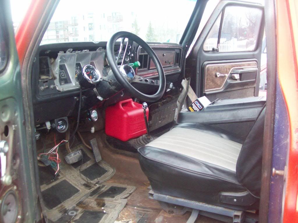

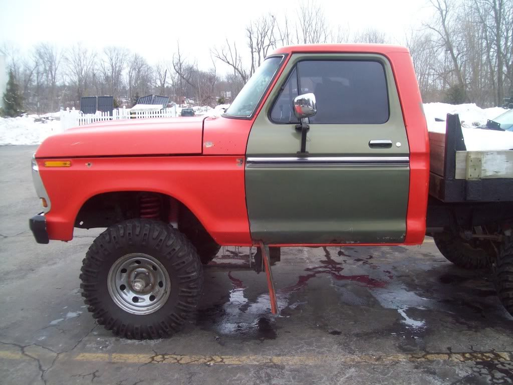

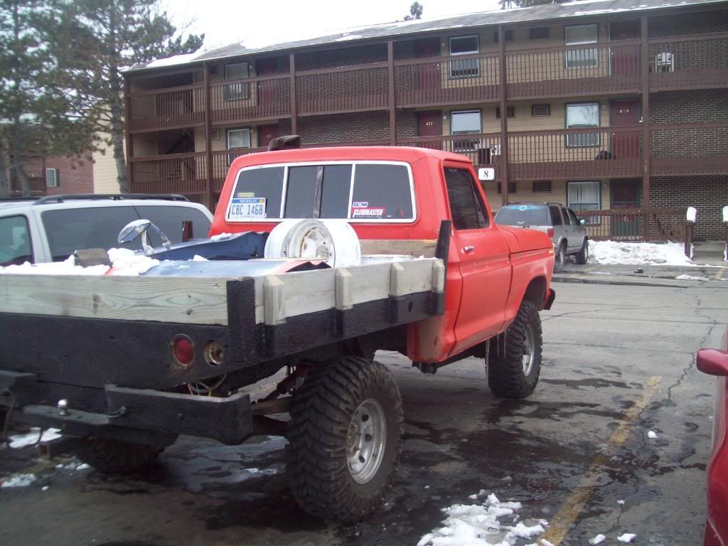

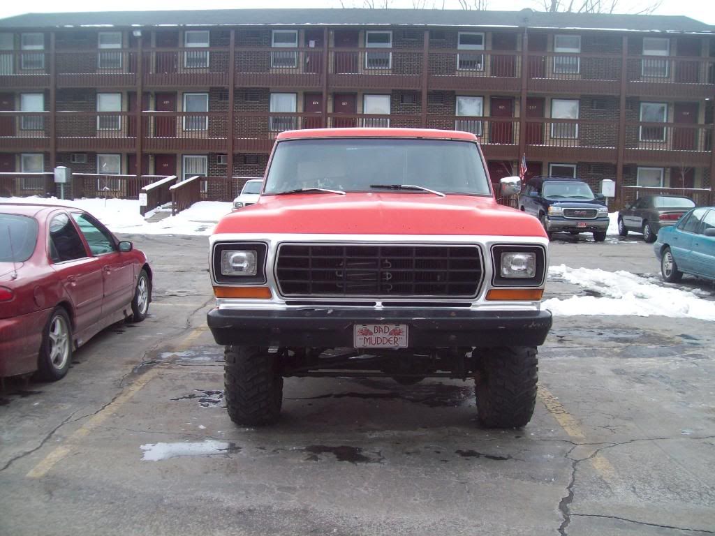

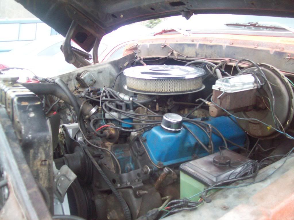

My new project is a 1978 F-150 the engine is a 400m, C-6 tranny with a B&M shift kit, 205 t-case and sitting on 1/2 ton axels with a 6 inch suspension lift. My plans this summer is to rebuild the engine or I have been considering On getting a 390 for it and rebuilding that. I looking at getting a set of 3/4 or 1 ton axels but still not sure yet. Any advice from ford guys is welcome.
Here are a few pics
#1
if you change  from the  400  or  351M ( there  differnt )  the  trany  wont  work  with the  390 (FE ) block.
351C, 351M, 400, 429, 460   your trany will work with  any one of  these.
REDNECKONE
Thanks ranger dave if i went to the 390 what tranny do i need
don't  know  i stay away from the  FE  blocks
