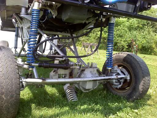

How can i stop the body roll guy's i could really use some help here :( if i get on the tire's and some one else is on the other side you can move back and fourth and the whole truck moves like 3 foot and when you drive it when you turn it lean's so much it feel's like it's guna flip any answer! help me thank's
BAD APPLE
did u get a sway bar that will get rid of a lot

ill have to make one im just not sure how to make it yet i want to do it once and have it last buti just would like it to work for now
BAD APPLE
With those big shocks a sway bar is the way to go as for a sway bar just get one out of. A full size truck and modify it to fit on ur frame and axles

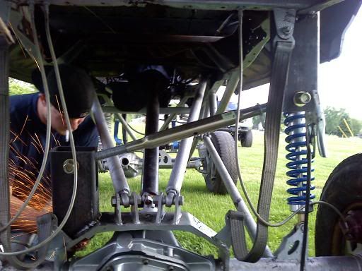

prostock2414

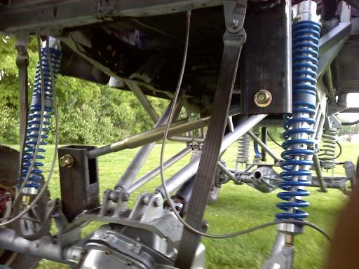

what do you think cutin the front end off tommoro to finaly put my big shock's on!
BAD APPLE
thats not gunna help much with the body sway thats jsut a pan hard bar keeps the axle from going side to side which u dont need because of the way ur top link bars are set up

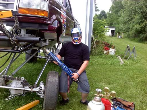

prostock2414
front shock's are done and on!
