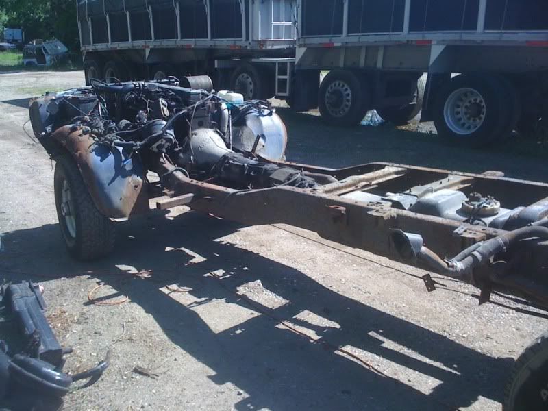

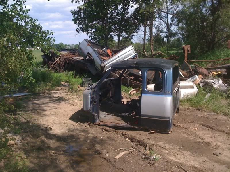

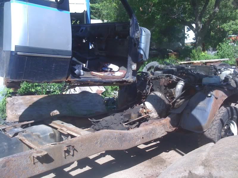

80 crew started life with a 360/727/205 but that wasnt what i wanted, so now its getting a 12v 6bt cummins. got brand new floor pans for it, gonna swap everything from the inside of the 93 ext cab over to the crew also. the 93 body is trash but doors are still good so ill keep them

woot. shes getting ready to go under the knife, cummins will be in and running by the end of the month, the new BUILT trans will be done in 2 weeks. picking up a 93 front clip this week. once its all together and done it will be getting a nice new coat of house of colors flat black, new pair of shoes and some brand used wheels.
