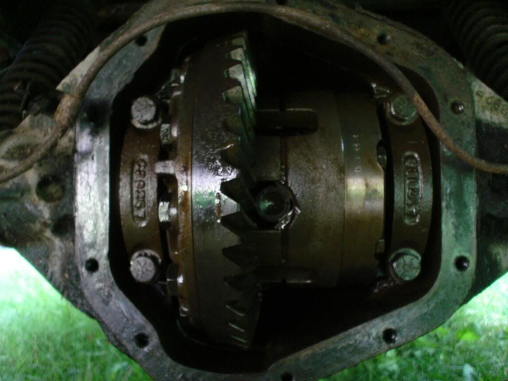

GM offered 2 axle options for its 3/4 tons during the 67-72 body style. The dana 60 was one of them, this axle has its original metal  ID tag held in place by the diff cover bolts (its hard to see in photo) (ALL Dana built  axles come with a ID tag telling what its axle ratio is but over time the tags can rot off, get lost ect.). It also list's that it has positraction and that special additive is required when changing the gear oil. This axle came with 4.56 gears, but other ratios were offered. The Dana 60 was & still is a very popular axle. FORD, DODGE, both used it throughout the 60's , 70's and 80's as a front & rear axle. FORD stopped using it as a rear axle in the mid 80's when they went to the Stirling 10 1/2 inch rear axle. DODGE used it as a front and rear axle into the 90's........and possibly early 2000's. GM stopped using the dana 60 as a rear axle in 1972 in pickup trucks, HOWEVER......some late model Chevy 3/4 ton vans..........and even Ford Vans have been offered with the dana 60 rear axle.  GM began using the Dana 60 as a front axle in its 1977 model 1 ton K30's......and continued to use it until 1991. NOTE: GM did use the Dana 70 as a rear axle option in 73-up dually 1 tons.
All Dana built axles come with a ratio tag, and if equipted with a posi unit will have a limited slip tag on the diff cover. Here is what my 67's rear dana 60 came with.  41-9 + 4.56 gearing.
Dana 60 factory Power Lok limted slip my 67 came with.

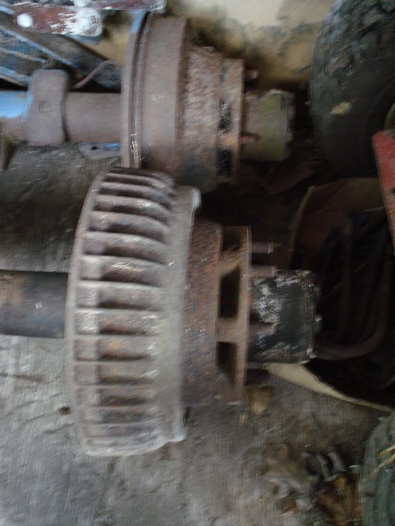

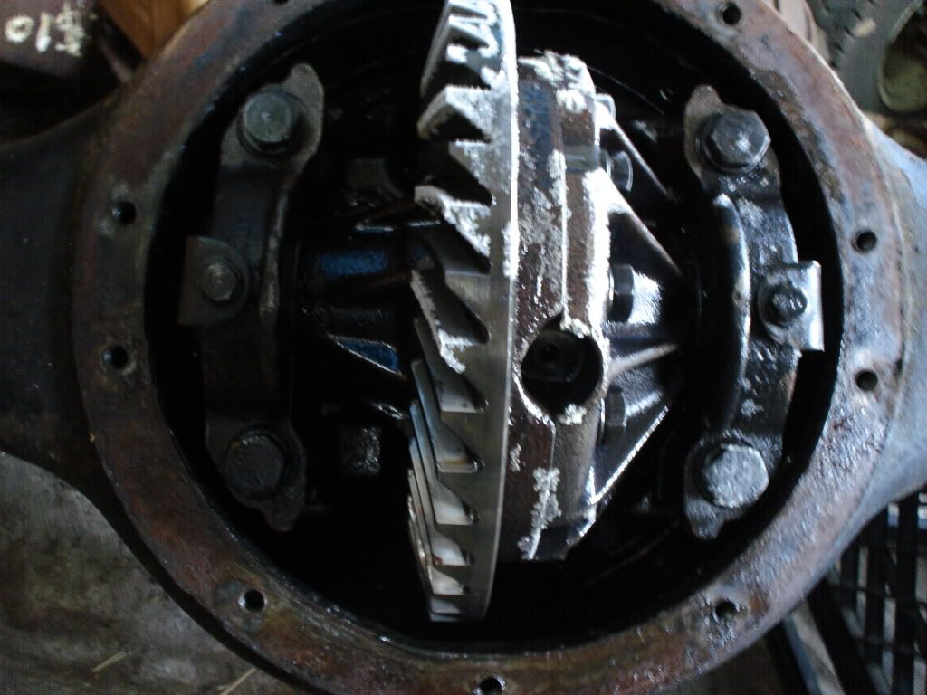

EATON HO52 rear axle: This heavy 3/4 ton 1 ton rear axle was the 2nd axle that GM offered under its 3/4 ton 4wd trucks, and 2wd drive 3/4 & 1 ton trucks during the 67-72 period.  The Eaton was used by GM since the late 50's/early 60's.....and continued till it was discontinued after the 1972 model year. At first glance, this axle looks like a jumbo ford 9 inch.  It does have a drop out carrier (3rd member) and is full floating. Axle ratios ranged from 4:11, 4:57, 5:14,......other ratios might have been offered, but these seem to be the most common. This axle has large axle shafts, but its splines are the old style thick/corse 17 spline (unlike the 73-up 14 bolt which had 30 spline axle shafts) A factory Posi &  Detroit Locker was offered in this axle, and finding one can be hard. Currently there isnt anyone making traction units for this axle anymore. Brake parts can be hard to find for this axle.........since it hasnt been used since 1972. The Eaton is comparable in strength to the 73-up 14 bolt, i would personally say they are dead even in strength, but the 14 bolt does have larger diameter brake drums than the Eaton does. Some late 60's early 70's 3/4 ton 1 ton 4x4 International Harvester pickup trucks were offered with this rear axle.
Here is a picture of a 1967 4.57 gear ratio equipted Eaton axle that I have, the ring gear is dated 10/66. This axle came out of a 67 3/4 ton 4x4.

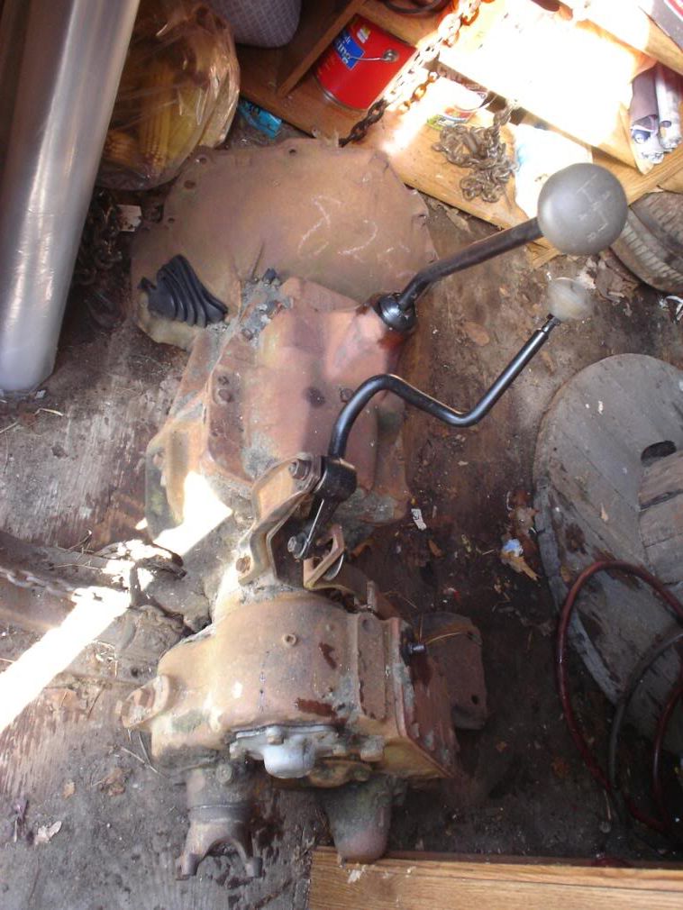

SM420 4spd: This was and still is considered by many 4wheelers as GM's best cast iron granny gear trans, although it is not well known, and not as common as the Sm465 is. It was first offered in 1947 and was used until the end of the 1967 model year. It's short compact size (the case is less than 12 inches long) made it ideal for those wanting to use it in short wheel base rigs. But the 7.06 1st gear made it the lowest geared light truck manual trans offered. Finding one of these transmissions can be hard (especially a 4x4 version) since all 1966-back GM 4x4's used 2wd Sm420's  and a divorce mounted transfer case.........and that 1967 was the only year it was used mated to the rockwell T-221 T-case. The shift pattern for this trans is nearly the same as the Sm465...............the only difference in the Sm420.......is that Reverse is to your left & back........instead of right & back on the 465. The SM420 only had 1 inspection cover/pto plate on it, it was located on the driverside as the photo shows.
Here is a picture of Sm420 trans/221 T-case levers  inside my 67 gmc k2500, notice the rockwell lever, situated on left side of the trans hump (much like that seen of Ford 4x4's)

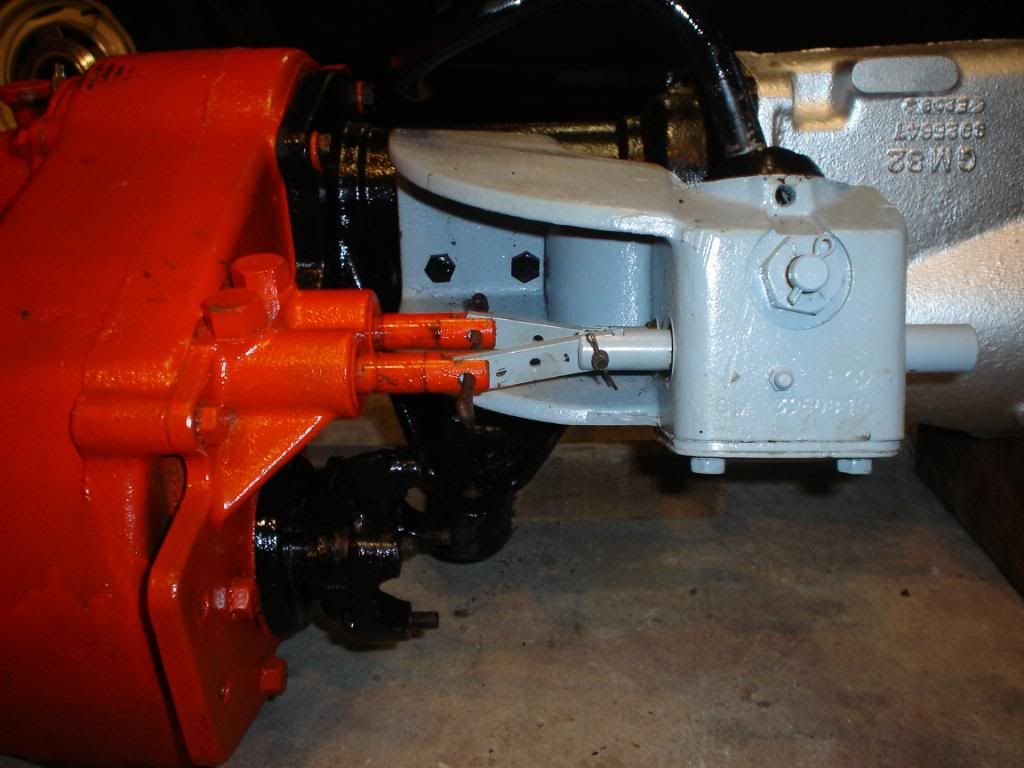

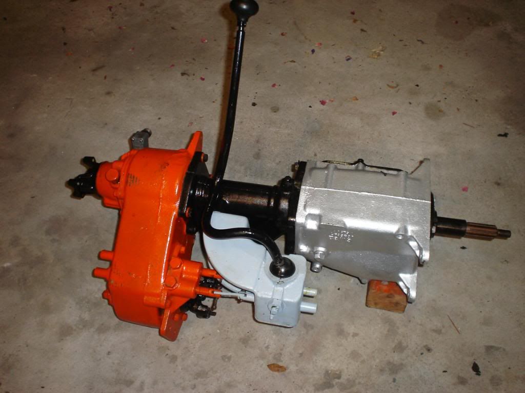

Here is a picture of the NEW for 1968... SM465 4spd......bolted to the Rockwell T221..........68 was the 1st year for the SM465....and last year for the rockwell T-221.You will notice the 4x4 lever.........it was re-bent to fit a 69-up (right side hole) chevy floor hump......the rockwell T-case is about the same size as the Np205. but has a large inspection cover on the top side of it. Also the 4spd knob came with a shift pattern engraved on it..........this was not seen on 67-back Sm420 knobs. The lower photo shows the fill/drain plugs located on the driverside of the T-221.
SM465 4spd: This very popular GM cast iron 4spd is the most popular (granny gear) chevy manual trans. It was used from 1968-1991/2. It came with a 6.54 1st gear, and had the option of PTO on the side of its Iron-cased housing.  Several varations exist of the 4x4 Sm465, and this really only depended on what transfer case was mounted behind it. The 1968-1980 10 spline rear output. And the 1981-92 32 spline rear output.  Shown here are pics of a mid 70's 465 that is 10 spline...and was used with the Np205. Also shown is a top cover showing the shift forks.

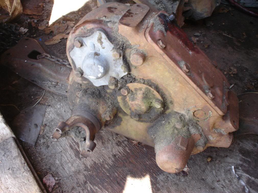

1969: The 69 model GM 4x4 saw the introduction of the new & venerable NP205. This gear to gear all cast Iron transfer case would be used by GM until 1991. Both Ford and Dodge made good use of this T-case as well. Known for being able to take a hell of beating and survive, its main drawback is that its low range is a 1.96. While the Np205 was used in the 1969 model 4x4's......and another transfer case was offered by GM as an option.
NP205: This cast iron gear driven transfer case was used by GM, Ford and Dodge, and even some international 4x4's, it was used for a number of years. Gm used it till 1991........Ford used it until 1979..........and Dodge used it till 1993. While it is strong in terms of strength/ hard use, its low range is only 1.96 and in the mid 70's ( speaking of GM trucks ) many were used behind manual transmissions that had a granny gear, and that sort of made up for the lack of a good low range. There is no linkage adjusment on the Np205, and in the late 1970's.......(78/79) GM began to offer the NP205 with a slip yoke rear and this continued until it was discontinued in 1991. Shown here is a Np205 that was used behind the SM465, and this has the (flat) (Saginaw) front driveshaft flange that GM switched to in 1977.  The Np205 also came with a PTO cover on the side of it.
Np205's can sometimes shift hard going into......or more likely shifting out of 4wd.......this can be attributed to the fact this T-case is non-synchronized, so you must stop or slow up to engauge 4wd.......or push in the clutch. I've seen some guys rock the truck back & forth to release the gear bind on 205's to get them back into 2wd.

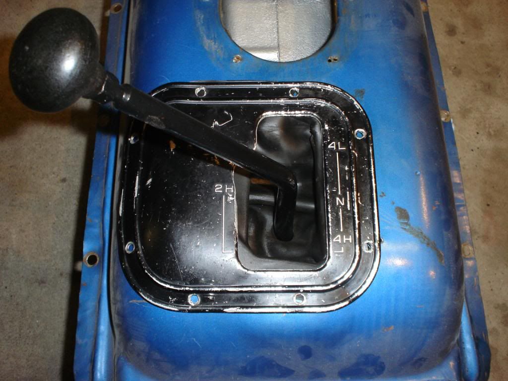

The Shift pattern for the Np205 was 4Hi ,2wd, N ,4Lo. Shown here is the 69-72 Glove box door sticker found in NP205 equipted Gm trucks.

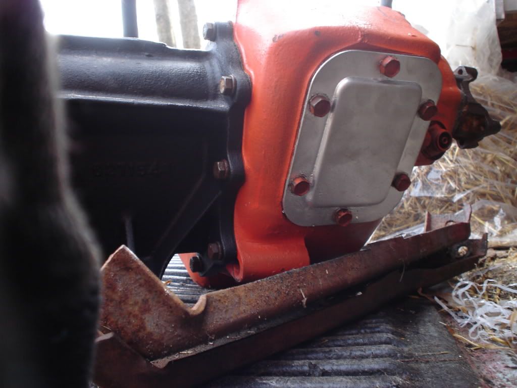

I just picked this up in june 2010 on craigslist, a very hard GM transfer case to find, and only offered for 5 years and only behind manual trans. Show are picks of a common small saginaw 3 speed hooked up to the rare GM version of the Dana 20, the shift linkage and lever assembly are more complex compared to the later NP203's.

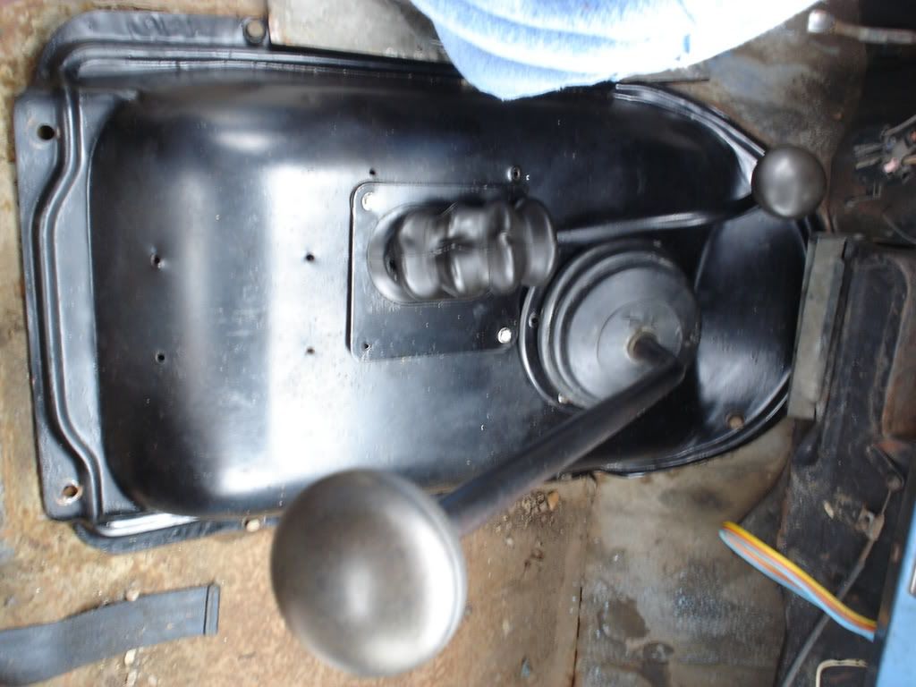

While this floor hump came out of 72 K5 with a Sm465/dana 20.........I figured I'd show what the lever assembly looked like with the dana 20 lever.

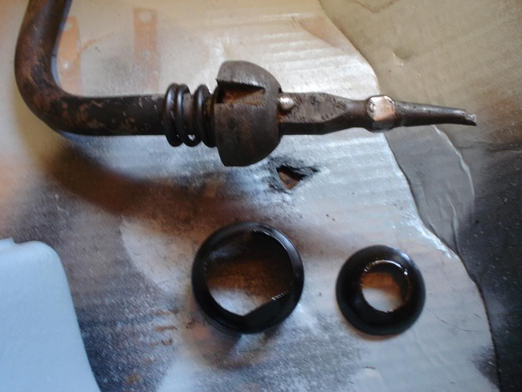

The GM Dana 20's shift lever and linkage is more complex than any other GM transfer case, The lever itself is interesting in that the base of it is very much like that of an SM465, the lever is held into the control box by roll pins and crush collar. Since the lever has a ( J ) style shift it must be able to Pivot, and the pivot box is filled with grease.  Inside the pivot box is a spring loaded bolt which allows the lever to slide and lock into its desired range. The GM dana 20 can be awkward to shift, because of its complex linkage system, which is why it draws complaints from those who've used it.
The pivot box has a grease zerk on the side of it, this is also where the spring loaded bolt is held on at to allow the lever to pivot into each range.

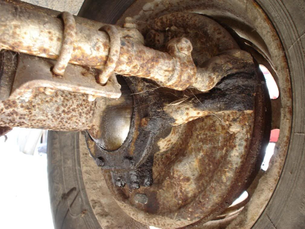

1972: HD44 front axle and Ho52 Eaton with posi, the front is 4.09 ratio, and the rear is 4.11. Both these axles came from a early 1972 3/4 ton. You will notice the Posi in the Eaton and the slight change in brake drums (my 1972 Eaton compared to my 1967 Eaton). Also the Front HD44's factory Spicer locking hubs with correct Blue knobs which were used for 1970-72 3/4 ton model's.

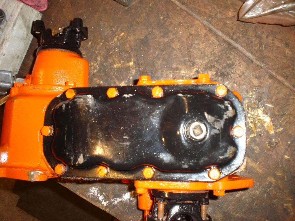

SHown here is the shift linkage and shift box for the Np203, the 203's linkage can be adjusted, and this can loosen up over time. There have been problems with shifting a Np203 (hard shifting) and loose linkage can be one of them, also remember too that since the 203 is full time, drive line bind up is possible while shifting from a Lock position to a Hi/low AWD position.

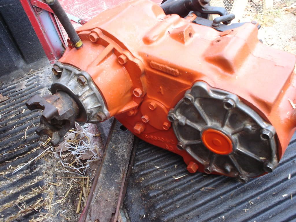

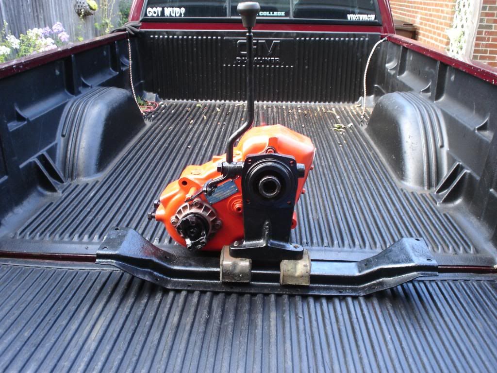

Shown here is a Fixed Yoke Np205 from a 350 turbo trans out of a 73 k20 that I purchased from "73chevytruck 8/2/10. The fixed yoke NP205s used behind automatics were not used very long. 1970-1973.......and were optional for 1974-75, but very few GM 74-75 4x4s were produced with Th350/Np205 combos.......as GM was pushing its Np203 behind most of its 4x4 drivetrain combos. Note the T-case shift knob is the later 75-78 version. 1973 and 74 GM 4x4 equipted with the NP205 retained the older 69-72 style Np205 shift knob.
