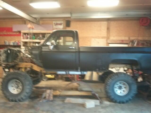

UPDATE:
Made my own 6" lift, Used 5/16 plate steel, Shackle flip in the rear, cut the old buckets out and reused them, Bed rail now sits at 6FT even, Floor boards are are 44".. Still have a few braces to weld in, but thats the just of what has been going on

AFurg85Chevy
Its getting there..suspen.sion is 95% done just need to get longer shocks and crossover steering..tires...then dump some money into the motor
