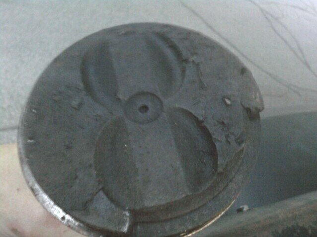

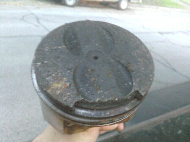

just puttin down the road literally puttin around 20 mph and BAM!!! this happens. lost all oil pressure and then she ran like crap. limped it home and found this crap. (#3 piston and # 4 piston) guess its time to start the rebuild now, the ol lady cant say no. ;)

IMO odd that it happened to two pistons. Maybe just old or most likely, a lean fuel condition combined with to much advance in timing. Too little top ring endgap combined with the lean or out of time will cause the top ring land to break off. Kinda weird to happen to an old (high mi) engine. Carb. change or timing adjust recently?
Recently bought a rebuilt 350 (should have done it myself). 3500 miles in it started missing BAD. Pulled plugs, 3 were smashed. 3 brand new hyper pistons had broken off the top ring lands due to too little ring endgap. Looked just like yours.

no timeing or carb work for a year didnt have a problem at all. no symptoms or anything. just bam then it was done.

ahhhh the joys of cast pistons......sucks tho
