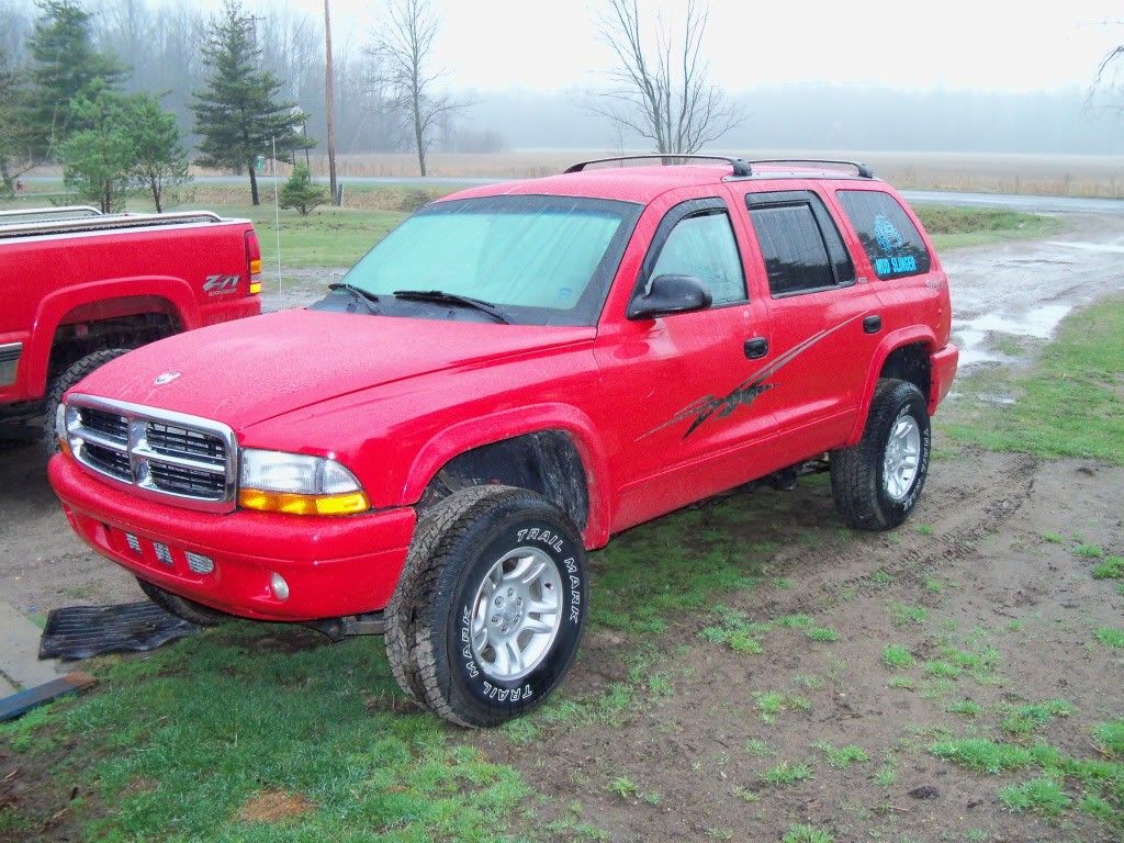

well i have a 2002   i bought with 62,000  i now have 138,000   on it i tow mud truck , a camper 26'
  and run this all over the state no problems    it has a 4.7 with 3:92 gears all wheel drive will have it on the next trail ride also     we did 2 wheelbeariings   and a power steering pump  I love mine  plastic bumpers too no rust     door bottoms and tail gate bottom  are 1st.
  good luck
  good luck
Yeah I seen your Durango and was talking to you about it back then on the new years trail ride, remember back then I was thinking about getting one. Now I am seriously thinking about it, I can just get so much more bang for the buck compared to a suburban of the same price as far as options, mileage and rust goes.
