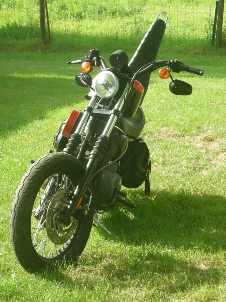

The weather's getting nice!  It's time to break out The Dirty Girl!

Nice what year is it and are those python pipes on there and where did you get the tall ass back rest? I've got a couple of bikes myself an 05 clasic and a 94 sporty. I put 175 miles on the dresser th other week when it was nice.

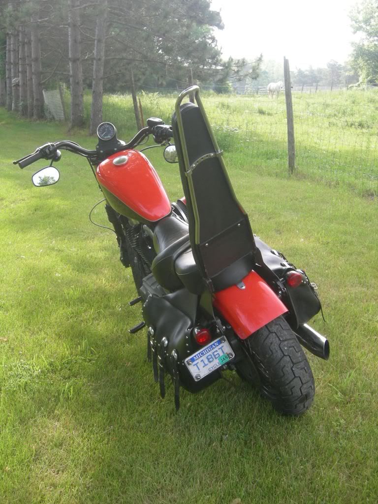

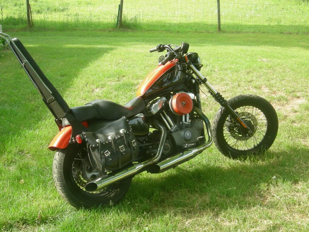

Thanks everyone!  72 Bogger, it's a 2008 Nightster and I've got around 55,000 miles on her.  The pipes are stock but I removed the chrome heat shields and cored the muffs.  I made the sissybar out of a Captain America sissybar from J & P that I welded to the H-D quick release backrest mounts.  I cut out a piece of plywood to match the contour of the bar and took it to Flint Auto Upholstery to have the pad made.  It's mounted to the bar by a couple t-nuts run into the plywood base and they're bolted to the bar using a factory H-D backrest clip and a crossbar that I welded in.  I can take the bar off and put on a solo seat in 2 minutes and it TOTALLY transforms the bike into a modern looking bar hopper.
