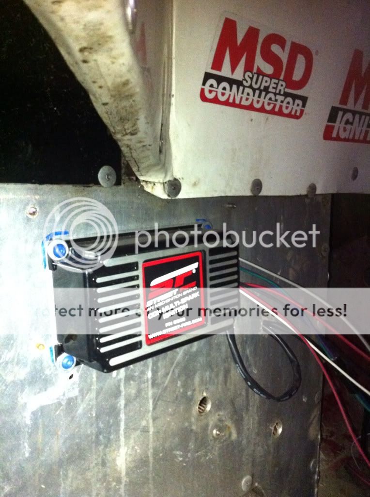

Cross member is done, swapped out drag links and reinforced it to accept the hydro steering- gotta get new tie rod ends, put orbital valve on still. Got the rear driveshaft made, gotta put the u joints in it still. All the msd ignition is in and mounted besides I gotta look up pro comp 8000 distributor to see which wire is what to run it to the msd ignition. Probably some I'm forgetting but I'll update pics soon

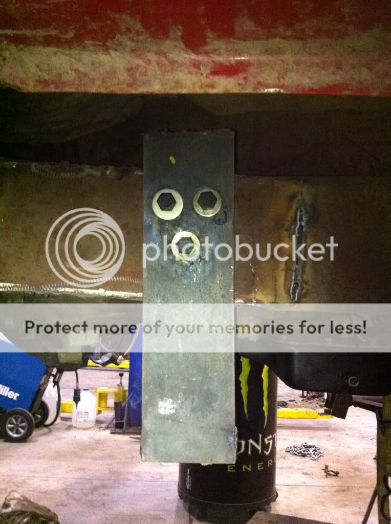

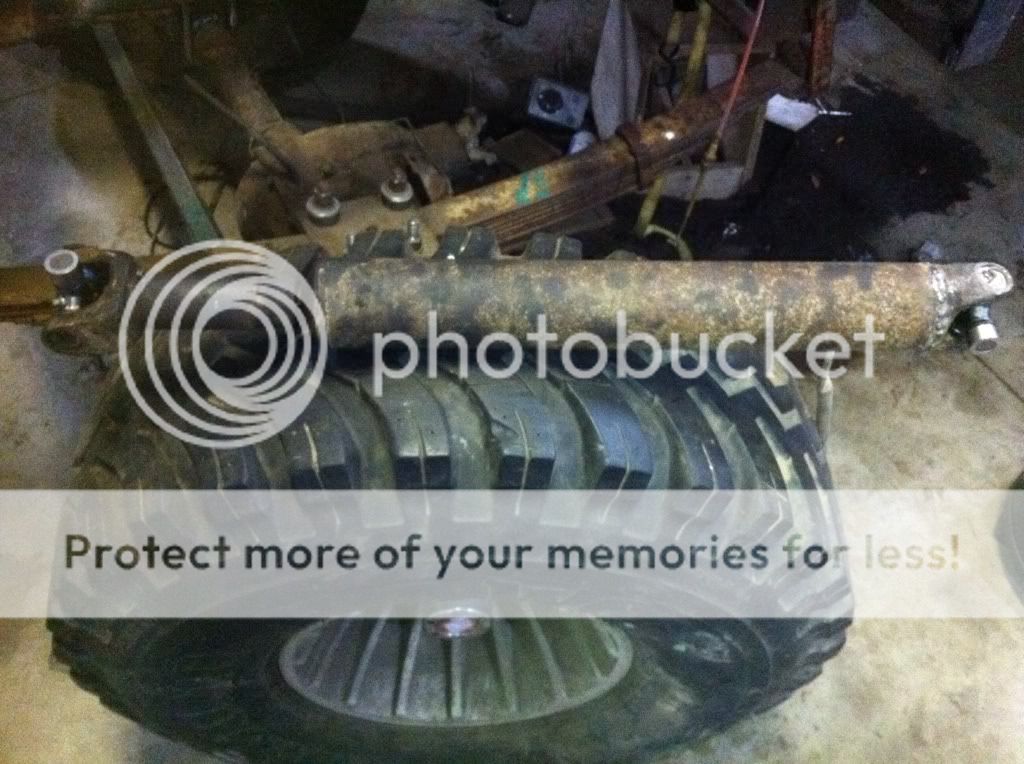

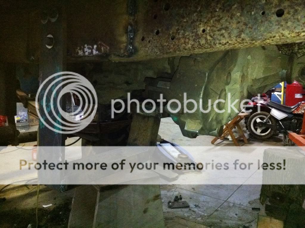

989F150904
Took some pics this morning befor work
989F150904
989F150904
The last pic of the cross member- I had to mount it on an angle to match the angle of the transmission mount so there wouldn't be tension always on it. I could've just changed the angle of the bottom piece of C channel to match it and welded the sides straight but was too late. Don't think either way would've been any better than the other anyway. Built in drive shaft loop in it too. That's why it's so low.
