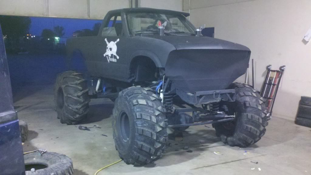

Got the tires finished today. I would hate to know how many hours are behind the groover. Got the wheels re-centered so all 4 are ready to bolt on. A good friend of mine put cab corners and rockers in today also. Did some testing this weekend. A couple jet changes and found the need for a gusset on the steering ram mount. Other then that went great. Hopefully can get the rest of the fab work done and painted tomarrow. Then adjust the valves, change the oil, seal up the moter and she will be ready for this weekend!

Truck did all i could ask from it. We had a little problem with a gap in the dog house on the moter and trashed an air filter. Had some issues with the throttle cable. But all in all truck performed great and put on a good show.

Went to another bog yesterday. Pit was kinda for 35in tire so we did some hole shots and high speed passes. Had trouble keeping the power steering belt on. End of the night the built a jump for us and we put the suspension to the test. Did great other then the front shock mounts had a design flaw. I only single sheer mounted them witch side loaded the shocks and bent them. Not bad for my first full 4 link build with cheap parts i dont think. Stayed in control and both of us that jumped it feel fine today.
