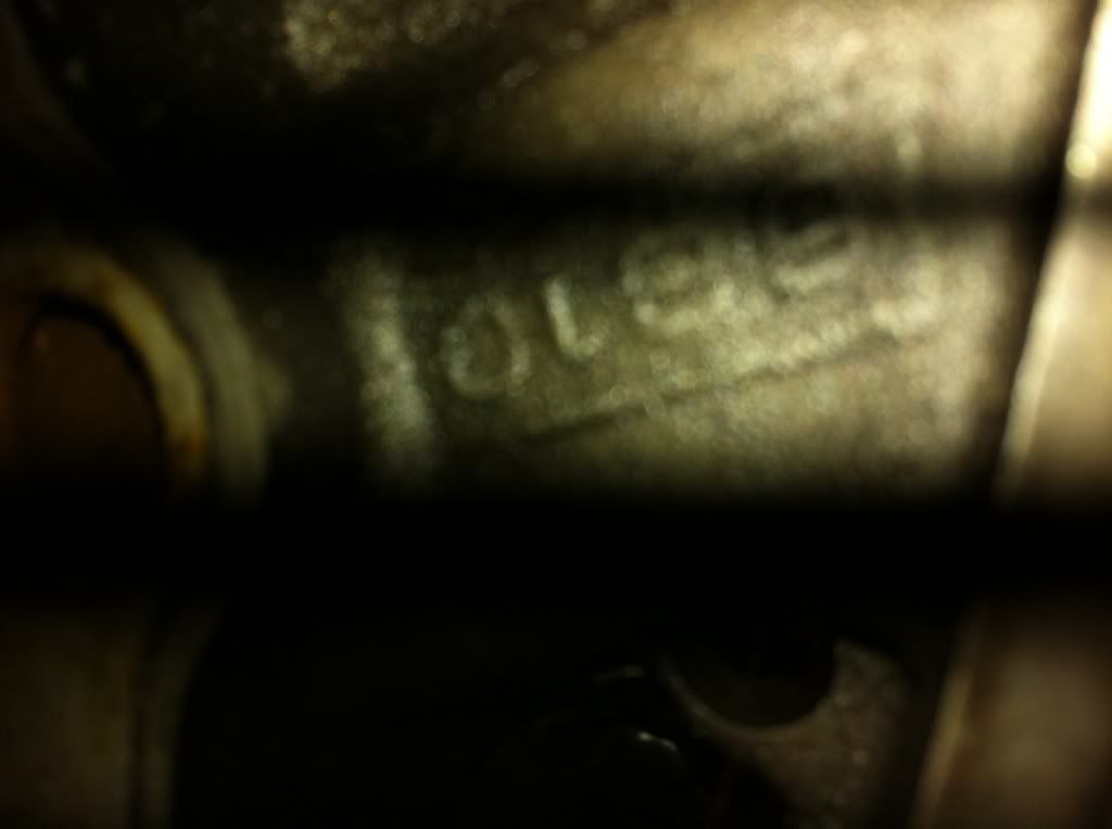

Cylinder side.   1     0 7 8 9 10     P
6613

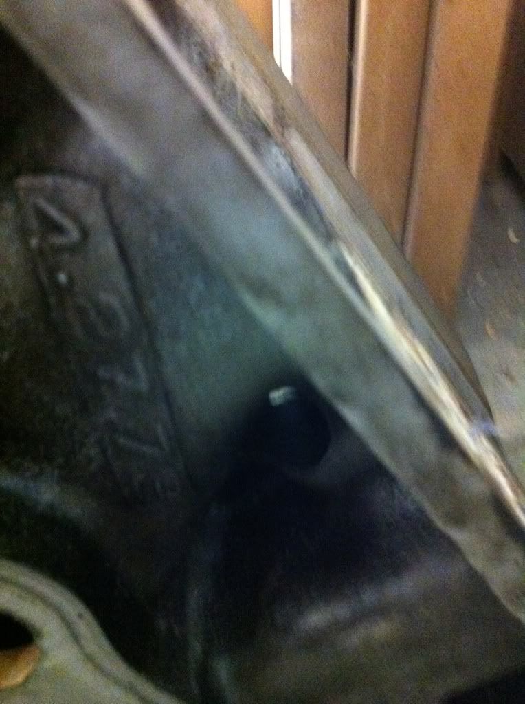

4.27.7.3

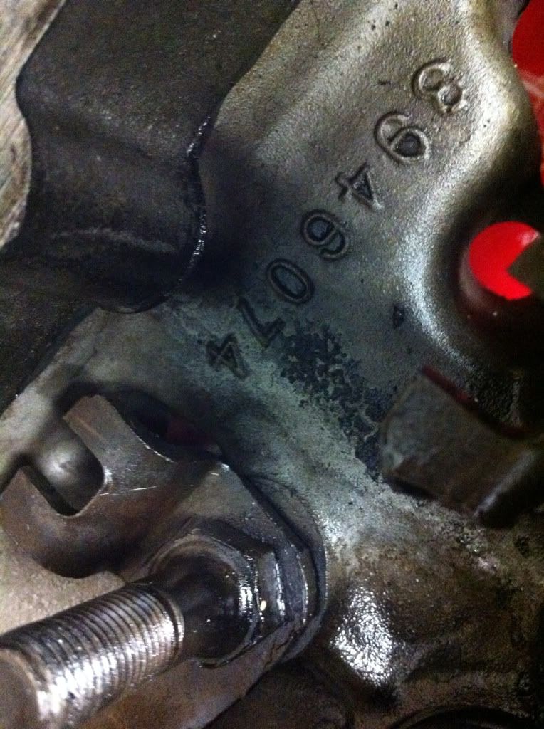

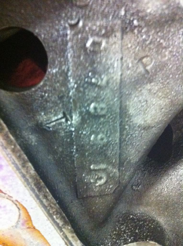

Top side casting #.  3946074

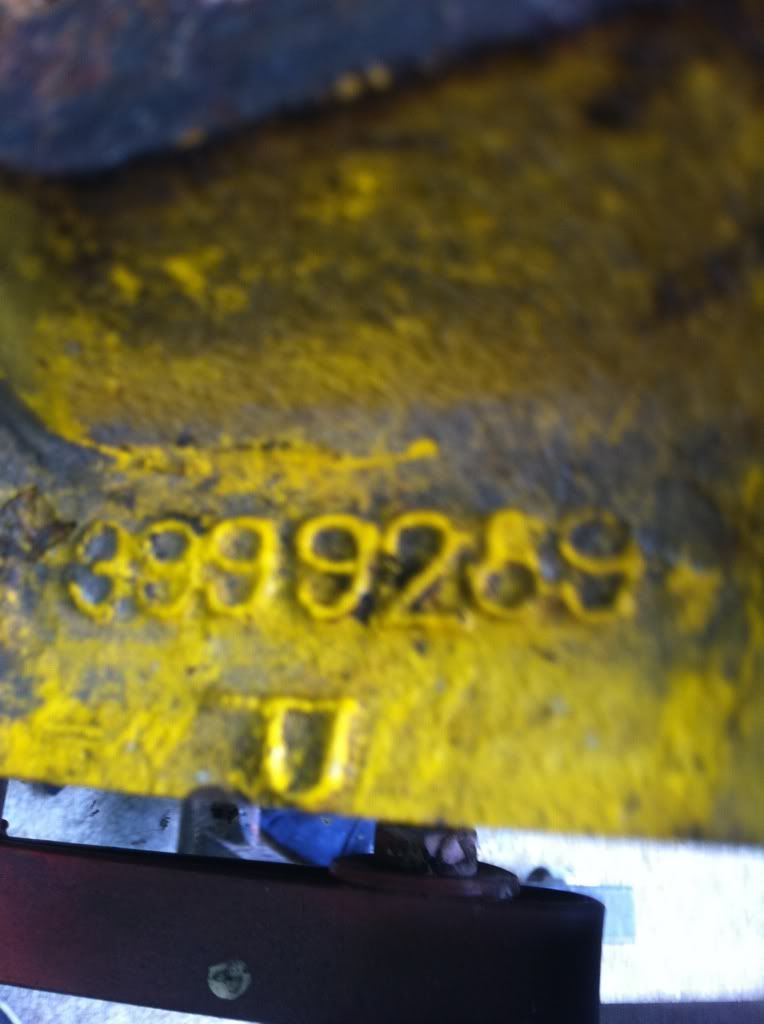

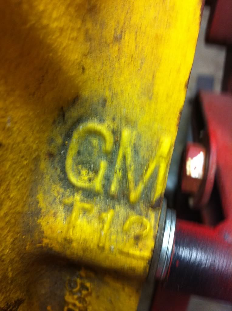

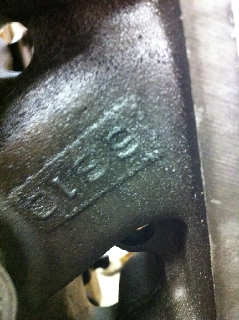

Iron Block 4bolt main
Casting number 3999289 P

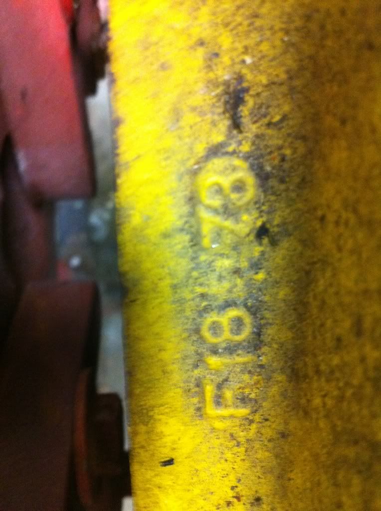

Other markings. F18 73
GM T12
PASS
HI-PERF
It was a 427. The heads are ported/polished/flowed
I don't really know what any of it is worth, or what kind of power I could make with the heads. Tell me anything lol
xjs3667
its a  72-78 454 block  probably out of a pick up.  these are good blocks also called the 289 blocks, even though they are listed as 2 bolt mains, the cap work is done after the casting, so yes there are 4 bolt main variations of the block.
Heads are 69-71 396, 402, and 454   open chambers 118cc
imo you should be able to make 400-450hp pretty easy :)
also im leanin more towars you got a 454 not 427, but really only way to tell is to crank cast number or measure it out.
Google baby google :)  its our best friend

its not a vortec block, they didn't even know what that was in the 70's.... it is a cast iron 454 block with 4 bolt mains, prolly has a shorter stroke crank to make it a 427 if it is a 427.
it is also possible that whoever you ordered it from took a 289, 454 2bolt main  block and machined it for 4 bolt, matched it with a shorter crank, and heads, thus your 427.
but it is not a true 427 block.

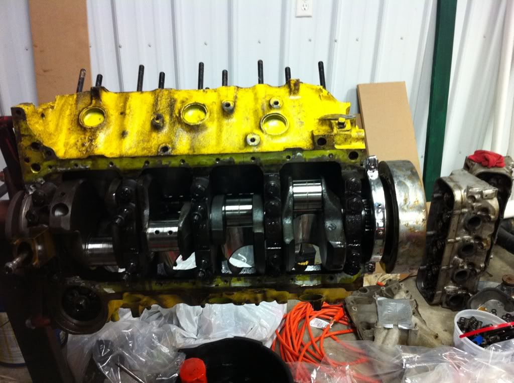

Jthomas

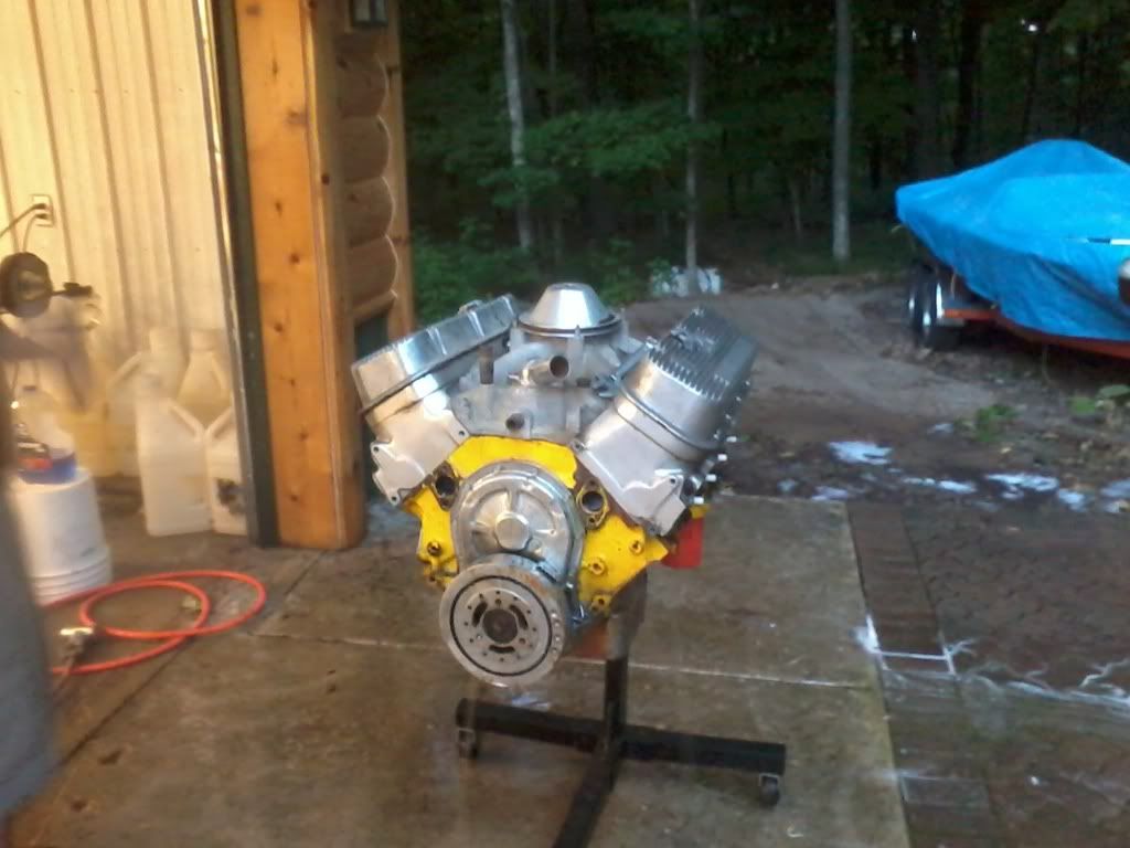

Befor teardown
Heads, combustion chamber side
Rocker side
4 bolt main 3.76 crank, internally balanced
