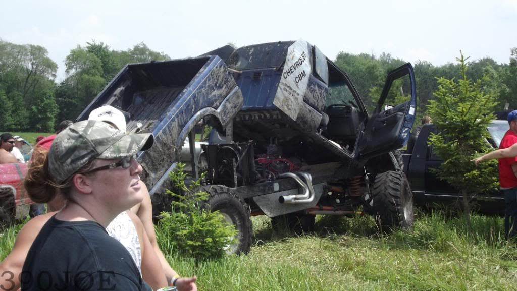

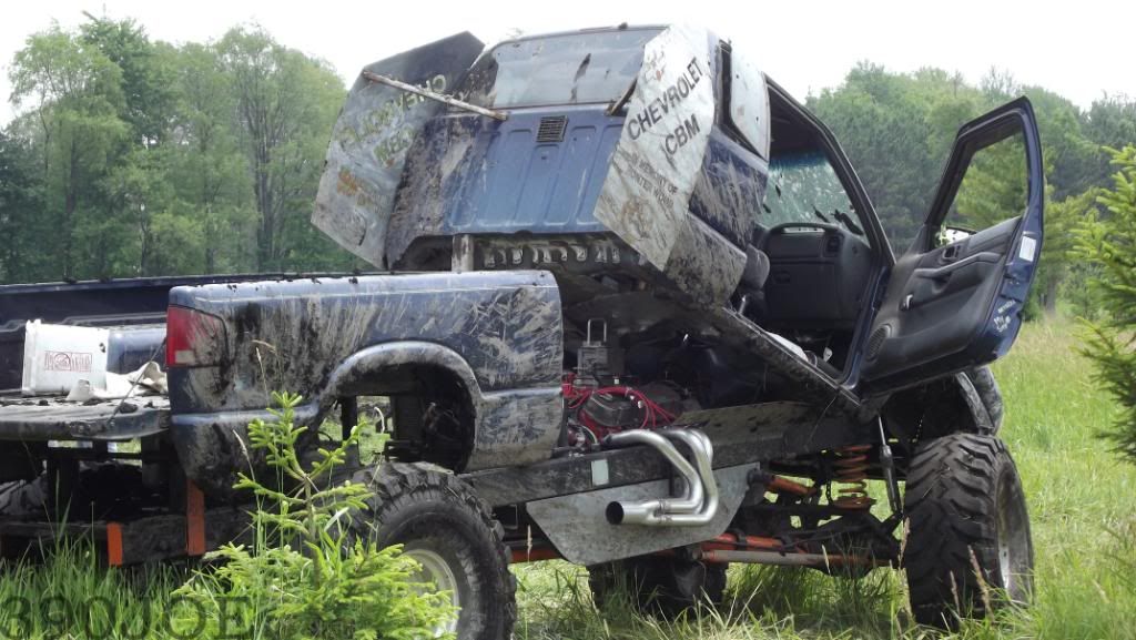

this might give you an idea of what to do
