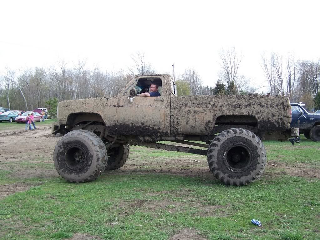

when I owned this truck,
it felt ALOT more stable, i think because it had 2x the footprint.
I guess i dont like that feeling that i might tip it, when really its on a 5 deg angle.  ==scared    ==np
