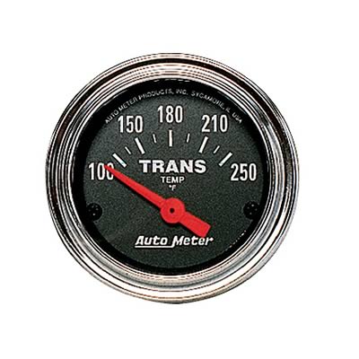

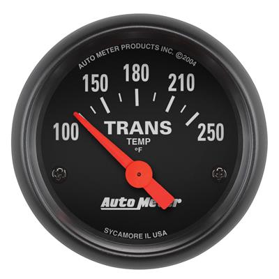

I run Autometer gauges. 2nd dd/tow rig I have used them on.
With Dexron VI, I  can run temps nearing 300s for short periods. Trans guy told me over 230 and I need to start backing down to let the trans cool back off though. If you hit 250, like most gauges are, you are starting to burn things up anyway.
It is normal, when towing the GN, that my trans runs near 200 degrees along with the engine. If it's under mid 80s temps, it'll run no hotter than 125. On 90+ days, it will normally get to about 175 just driving around.
This is on my current tow rig:
http://www.summitracing.com/parts/ATM-2640
And on my old tow rig:
http://www.summitracing.com/parts/ATM-2552
