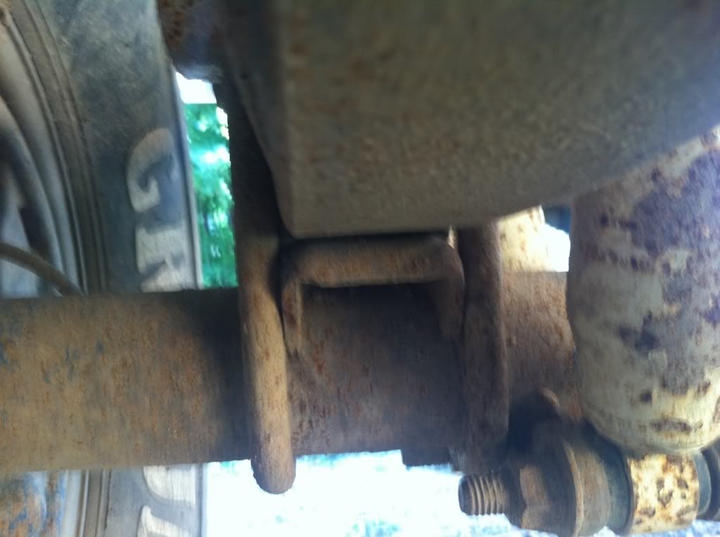

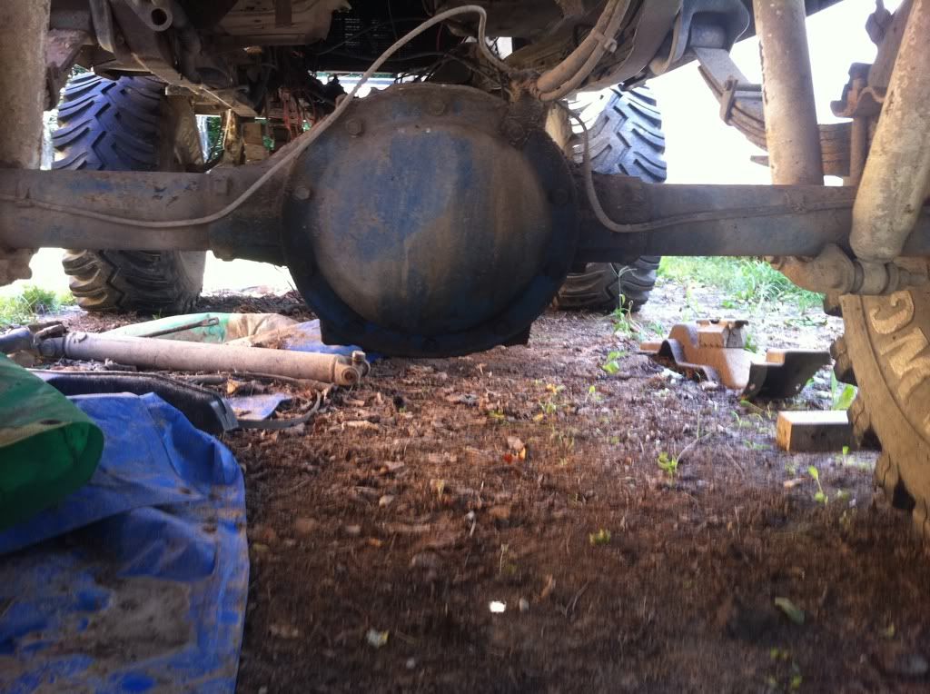

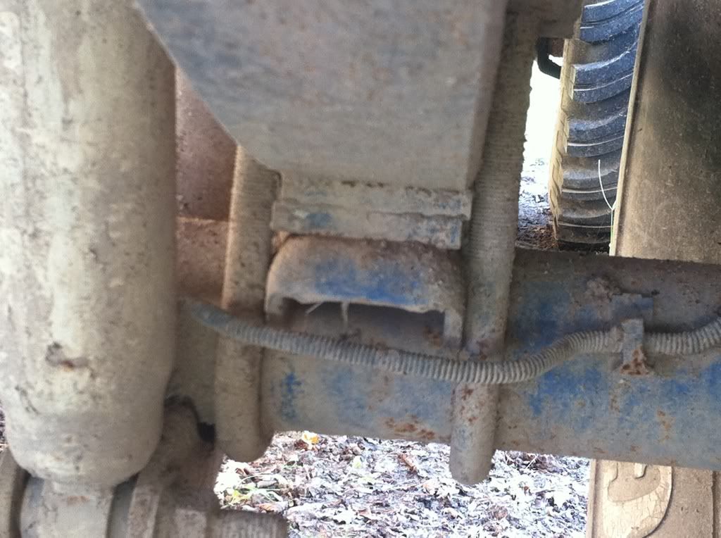

Here's my curent set up

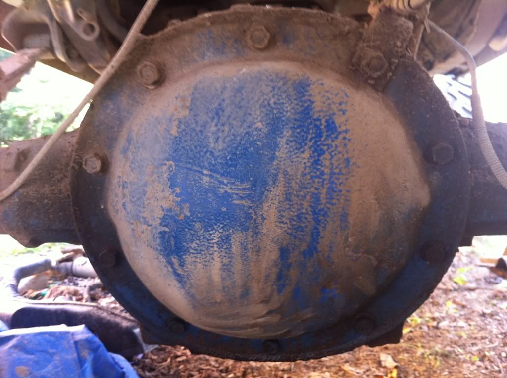

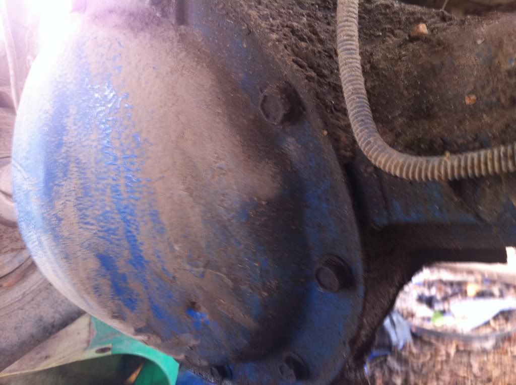

Stock 10 bolts. When I bought the truck, I was told they were Dana 44s. I really think thy are GM 10bolts?
They are shimed
And I'll have to remove my shock mount and weld on new rear end
Front of perch.

yep, those are ten bolts,
Ten bolt front axles were used by GM in 1/2 & 3/4 tons from 78-91.
Ten bolt rear axles were used from 82-91 in the solid axle 1/2 ton 4x4's.
Probably be easiest just to replace what you have, 10 bolts arent bad axles, they just dont like super big tires.........lol
