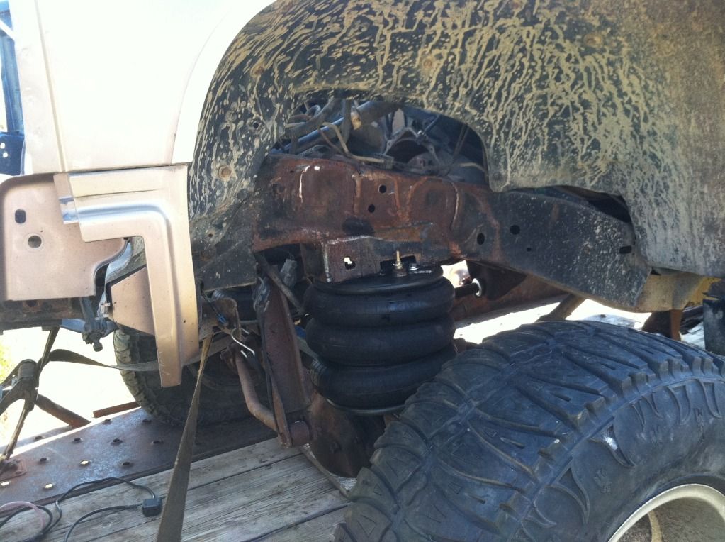

96 Tahoe radius arm front, currently has a 2 link rear going to go to a triangulated 4 link, bags on all 4 corners still has the 96 trans and push button case, along with all the wireing intact to put a Vortec motor back in. To get it going all I need to do is come up with steering shocks brakes hook the track bars to the frame and motor and re do the rear. It's a ford hi pinion front with Chevy 6 lug outers and the stock 96 rear end for axles. Thinking about putting my 14 ff in when it gets 4 linked and my 8 lug outers on the front. Whatcha guys think??

Well the rear is way out of plumb going to pick me up some leafs and new hangers this upcoming week. Going to shackle flip it and a4" block with 2" aal so 10" of lift in the rear and probably going to have to either re do the front and move it 1 1/2" or so forward or just throw some leafs under it for the time being

They front may stay bagged yet  the rear is just a hot mess in my opinion with the axle centered they look like this \____^_____| the way the link bars are set up it will get no articulation, it's pretty much set up as a quad swing arm right now. And leafs will be the quickest to get it moving and wheeling by summer. maybe next winter if I keep it ill fab up a 4 link with the bags.

I think it be sweet you dont see alot of tahoes. And i bet i know a way you can four link it cheaper than you think.

How's that? And especially clean ones with a tail gate opposed to barn doors. Your not to far away if ya ever want to stop by and have some beers

 Wolverine boiler tube in leslie on church hill rd.  its only like a dollar per foot for 1.5 " tube. its like .180" thick and is actually pretty strong. and you can build your own tabs and brackets for a reasonable price.  all you need to do is buy heim joints and racingrodends.com have a set of eight with jam nuts and weld in bungs for like $140.00

my buddy ran it on his truck for like three years and only bent two bars. its a good cheap way to go. i did DOM on my truck and i had almost 500 in just tubing.
camok10
Ya synergy susp sells a universal 4 link with 4' Dom links all hemis and brackets for just under a grand that's the route I was gunna go
