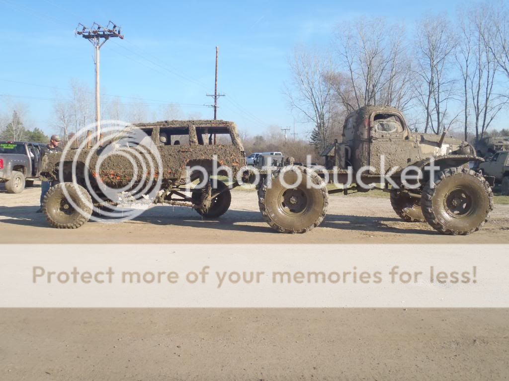

  on the left is what happens too a semi floater/c clip axel
