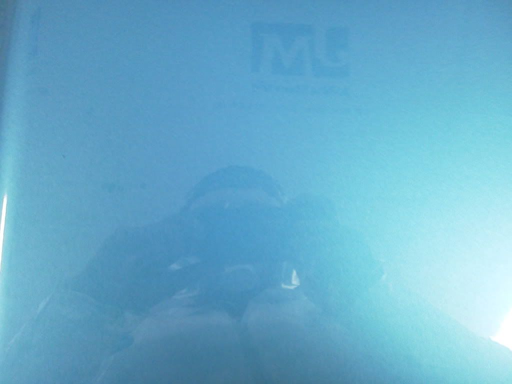

I put 4 coats of base and a drop coat to even the metallics. here are some pics of the clear just after it was sprayed. It is going to flow out like crazy. it is slightly peeled in the pics, but i might end up cutting the clear off the floor. lol
[url=http://i882.photobucket.com/albums/ac23/josephis09/IMG_20130814_200218.jpg][/URL]
[url=http://i882.photobucket.com/albums/ac23/josephis09/IMG_20130814_200231.jpg][/URL]
[url=http://i882.photobucket.com/albums/ac23/josephis09/IMG_20130814_200309.jpg][/URL]
I need to work on my ventilation some.
[url=http://i882.photobucket.com/albums/ac23/josephis09/IMG_20130814_200334.jpg][/URL]
