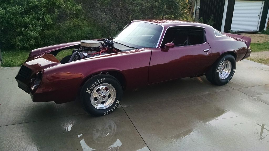

camaro project, got my motor back (couple pics now)
Started by marshall, March 25, 2013, 02:00:07 PM

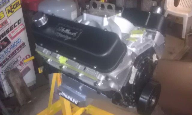

4 bolt main 454 bored and stroked to a 489 Chevy. eagle crank and rods, j & e pistons, brodix heads, victor jr intake, scorpion roller rockers, small solid roller cam. 10.5:1 compression street motor.

What are the specs on the motor?

This is a sweet car....saw this in person picts dont do it justice....got me itching to put my motor in mine.....cant wait to see her run

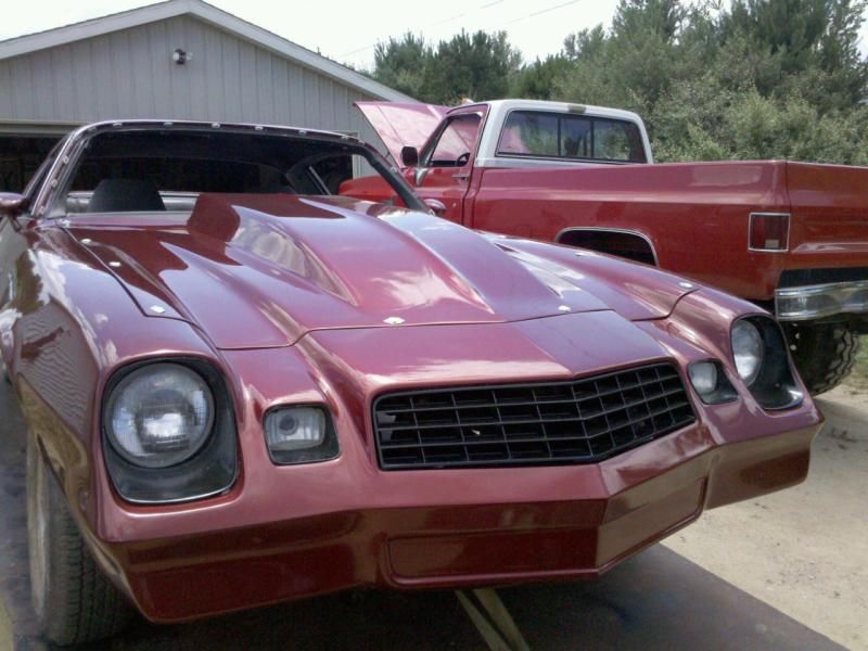

That's a bad ass ride man.  It's also cool that you keep it for so long.   ==wgm
looks hungry, I bet it will eat some mustangs...

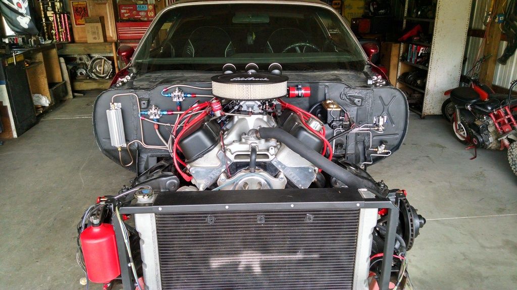

Need to wash it, put exhaust on it, and trim the front coil springs...it sits too high now even with the big block.
