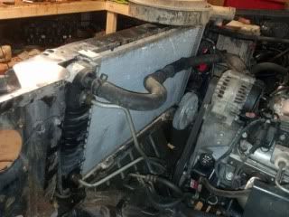

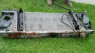

Picked up a radiator from the junkyard from a truck with a 6.0. This made it simple for my steam line and oil cooler.  Be sure to grab the surge tank too because your gonna need it. Also take the little c clip and grab the nut and some line so you don't have to buy those later for the trans and oil cooler.

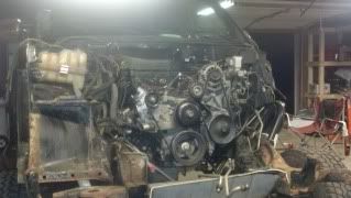

Motor went in pretty smooth. Transmission mounts lined up, dirty dingo mounts lined up, the oil cooler lines needed some bending but I made the stock ones work.
Fired right up first key turn.
