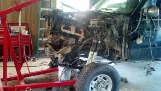

Well I made some progress. I got all my cab mounts replaced so now my fenders actually fit again. I got the core support off, carb off, distributor pulled, exhaust loose, starter out, driveshafts off.  U know all the easy stuff.  The 350 and 700r4 are almost ready to come out.  Just have the transfer case to take out then it should be out shortly after that.
I also got my engine harness and computer removed from the 6.0.
I got my motor mounts too.
Carb or efi?  Stay tuned!

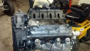

Ok i got some progress done.
Looks way better with the coils gone.  I might look into rerouting them depending on cost.
I'd say that looks pretty clean!
Im going to cut all the unused tbi wires out.  There should only be a few i will use like ground,ignition, tach, alrernator, starter, vss, temp sensor, and oil pressure.
